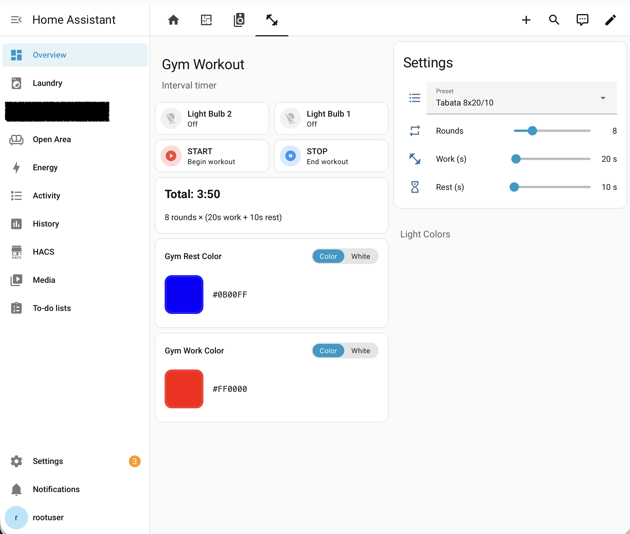

Here's the page on my dashboard that uses this: a workout interval timer that changes the lights to specific colors to notify me that it's time to sprint (work) or rest in my home gym:
Please do let me know if this is useful to you!
