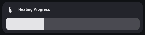

Here’s a basic example using Custom Card Features:
Card Configuration
type: tile
entity: sensor.bthome_sensor_1234_temperature
hide_state: true
vertical: false
features:
  - type: custom:service-call
    entries:
      - type: slider
        thumb: flat
        entity_id: sensor.bthome_sensor_1234_temperature
        range:
          - 20.5
          - "{{ states('input_number.xxx')|float(0) }}"
features_position: bottom
