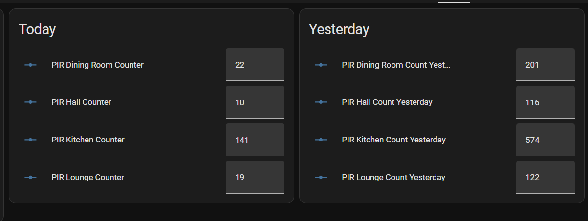

Where there’s an input field for an ‘input number’, there used to be little up and down arrows appear, when the cursor hovered over the number box, to enable increase or decrease in value.
They’ve now gone, but I don’t know when it happened.

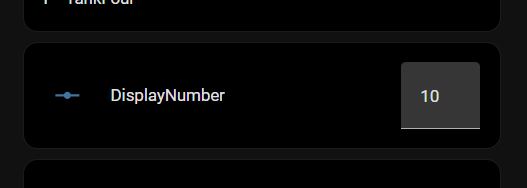

The single display above is an entities card on a dashboard with a Sections layout.
Those shown here are on an entites card on a dashboard with a Masonry layout.
I’m sure they all had in/dec buttons before.

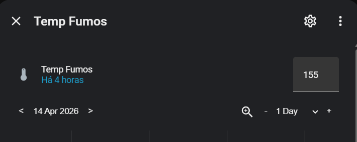

I just noticed this too, I think it’s 2026.4 that has done it.
