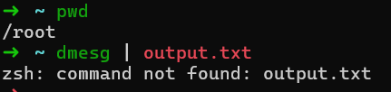

I ssh’d into home assistant and ran the above command and got this response. Its not showing ha so I assume this is at the linux command line.

Sorry, change the | to a >
Thanks that works. It hasn’t crashed the last 2 days. As soon as it crashes next I’ll run this again when I can easily find the issue.
