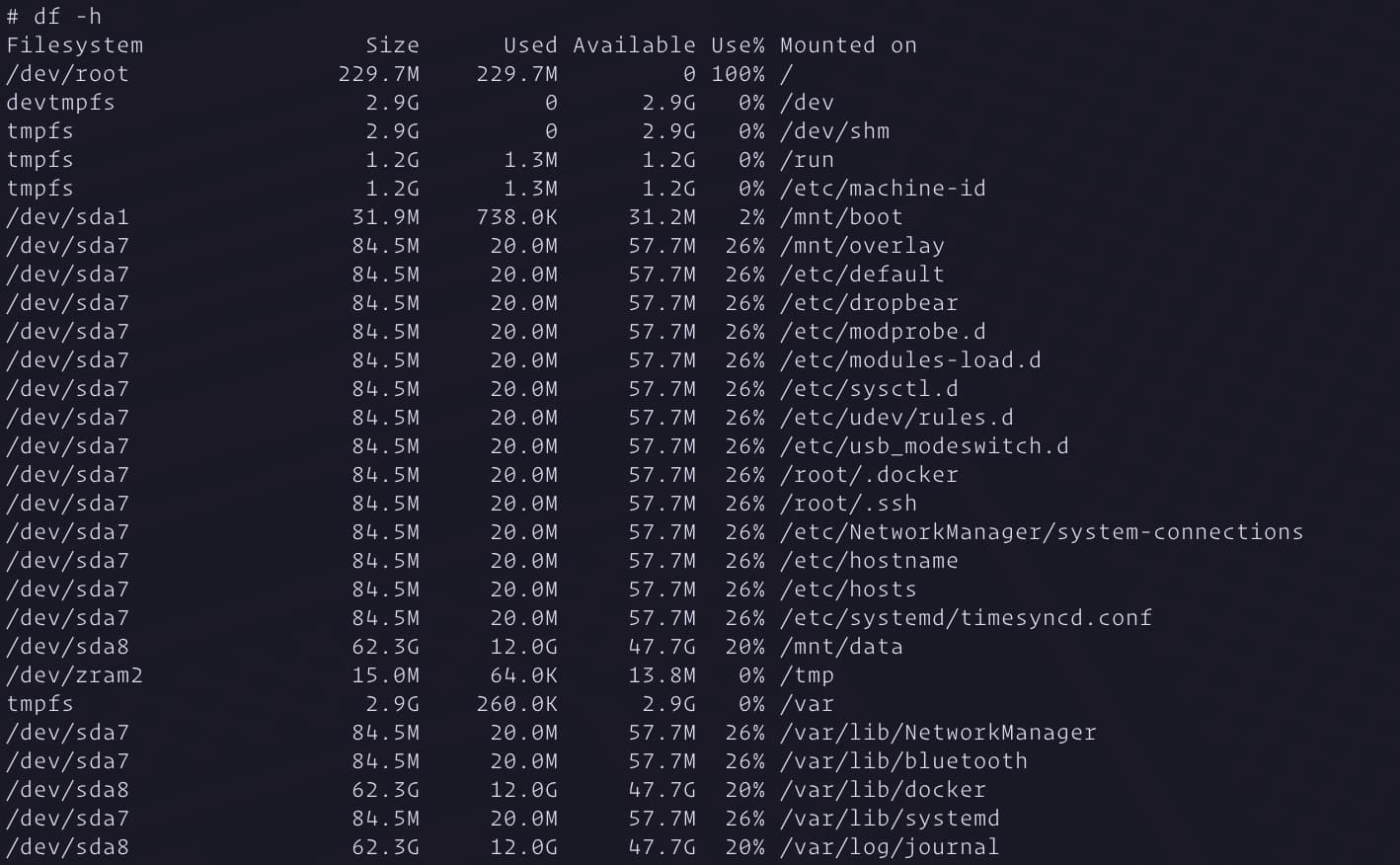

So a few things, I see that there’s a few mounted dirs that are writeable
What would you guys recommend for putting some statically compiled binaries like lazydocker, for example?
Second, are there any tips about getting some extra packages on there? I’m really missing vim, htop, lazydocker like I mentioned, and a few others. I know vi is there, same with top, but those are shit :sweat_smile: I see some folks mentioned apk (the alpine package manager) in other posts, but that’s not in the host HAOS instance, right, that would be in one of the containers which is not what I’m looking for.
