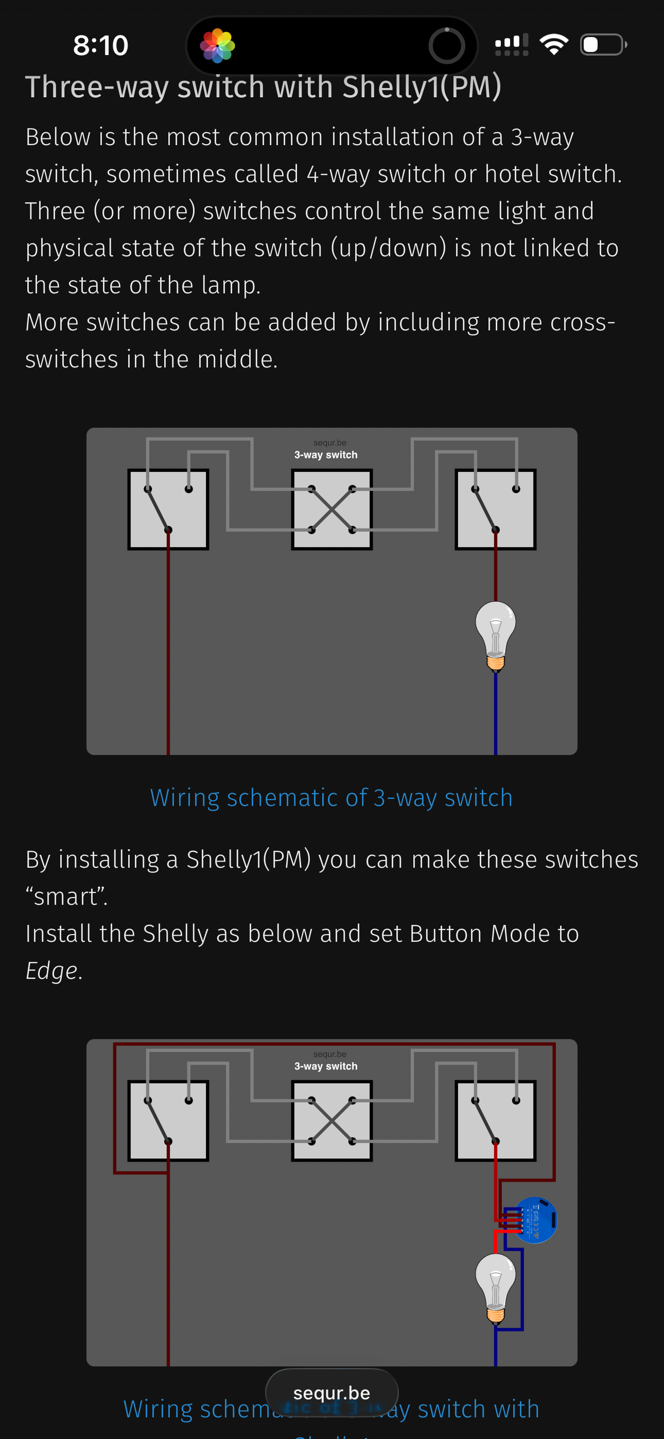

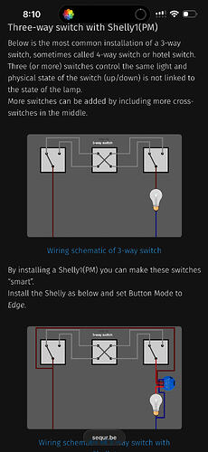

Here’s some instruction for 3 way switches
This is exactly what i ment. Light & shelly in the samen place. Just add 1 extra wire. This is the best option.
