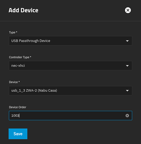

I’ve had some time to test the ZWA-2 in my HAOS VM, and it appears to work as expected.
Here’s the setting I used when adding it to the VM

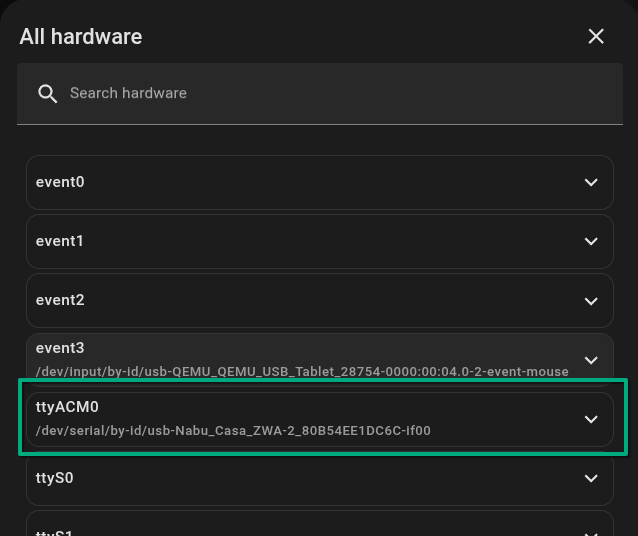

You can confirm it shows up in Home Assistant by going to Settings > System > Hardware and clicking on All hardware
On my system, it appears as ttyACM0. However, in the Z-Wave JS UI add-on, it is listed under /dev/serial/by-id/..., which is the preferred method for connecting to it.
