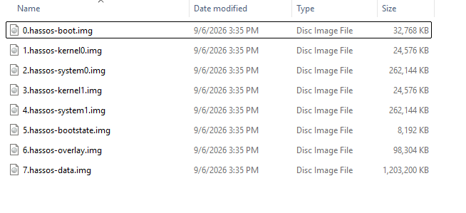

Greetings, I’ve been in AI hell trying to get this installation going. I have a hpprodesk and I’m trying to get a zigbee sensor and dongle to work in addition to other govee sensor and plugs. I’m stuck on the installation of windows HA and oracle virtual box boot. When I download
https://github.com/home-assistant/operating-system/releases/download/18.2/haos_ova-18.2.vdi.zip it extracts into 8 files.

Thanks but it still downloads as zip and extracts into 8 files. I’m using zip/unzip.

How? It’s a zip with a .vdi inside it. You don’t unzip the .vdi, just point to it in Virtualbox.
In windows just double click the file, drag the vdi outside it somewhere and then point to it in VB.
I’ll try some more but when I click on link. It downloads and looks like this

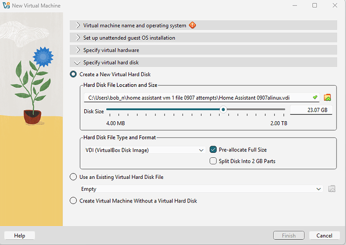

I can’t get oracle virtual box to accept. If I click it unzips to 8 files.

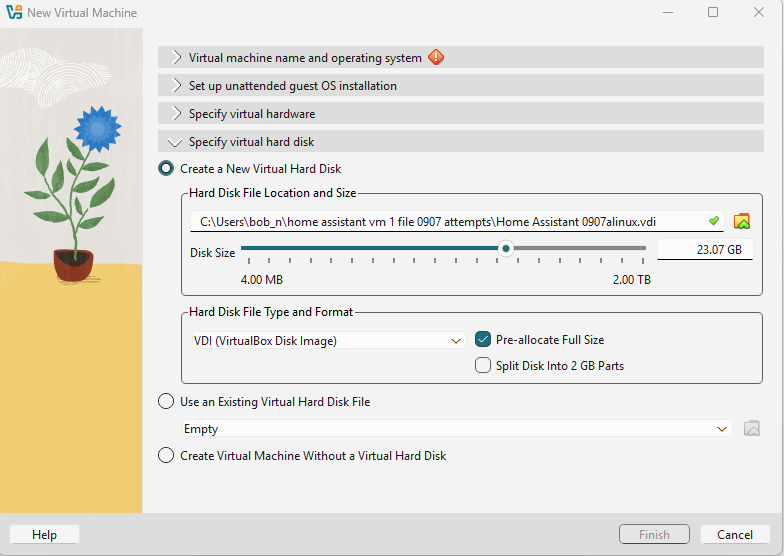

Tried more ways. Seems progress but can’t get this to finish..
You don’t want to create a new disk,you want to use the existing vdi you unzipped. Follow the guide closely. Use the option below the one you have checked, point that to the vdi.
Thanks. That below one was the one AI etc pointed me too. It doesn’t like the download. If i click on the file it extracts as 8 files… ground hog day.

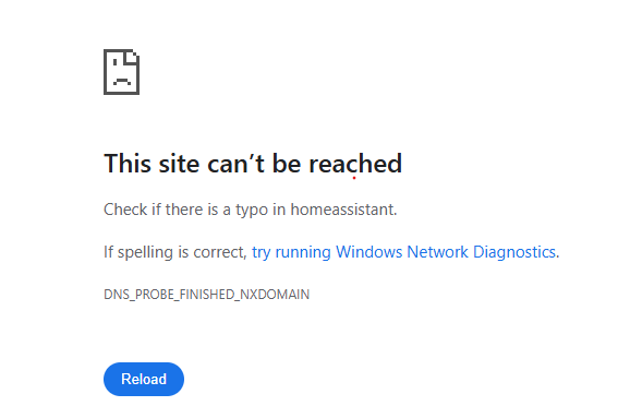

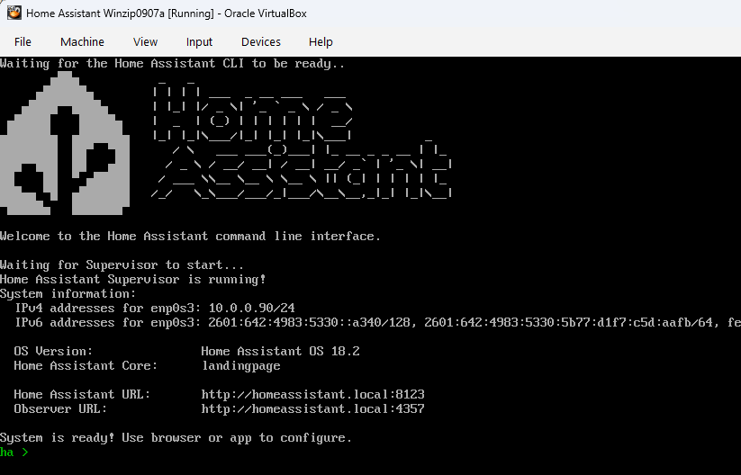

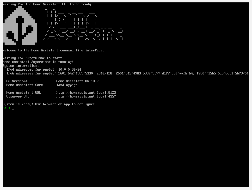

Time to try onboarding, starting here
and, drum roll…

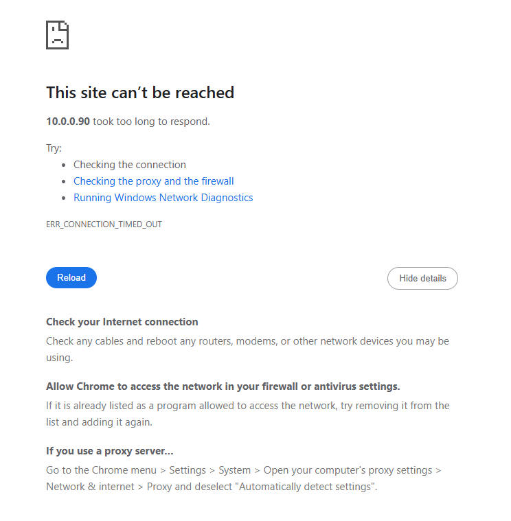

Have you tried
http://10.0.0.90:8123
If that works you have issues with mDNS

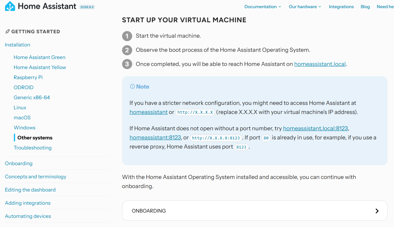

try with port ( :80 ) http://x.x.x.x:80

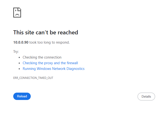

Thanks, that didn’t work.

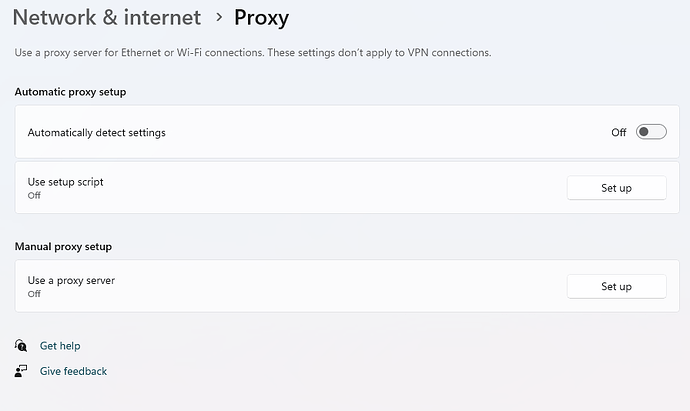

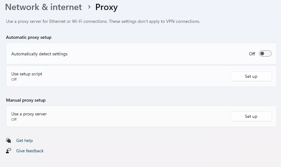

Went here, and now deselected
same result when deselected
Thanks.. what goes in the x spots?
