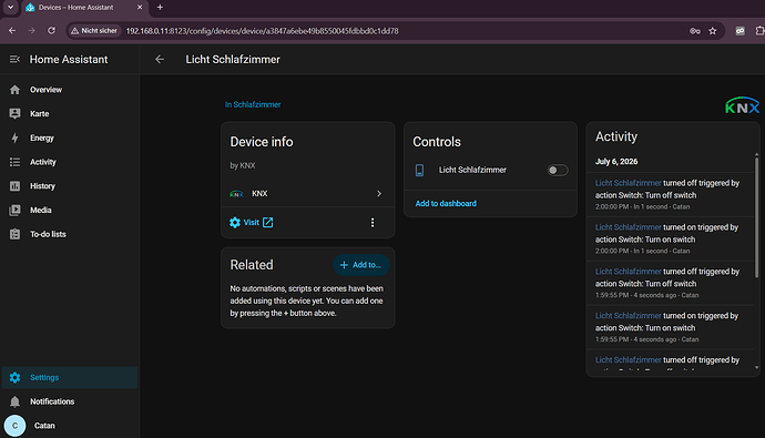

The KNX integration is particularly exciting. Because the hardware features a native KNX TP interface and can act as a KNX Router/IP interface, you can bridge your Home Assistant ecosystem to physical KNX actuators flawlessly.
I have already successfully coupled physical KNX hardware with the Catan C1, and it works incredibly well. Here is a quick look at my successful KNX bus connection through the device:

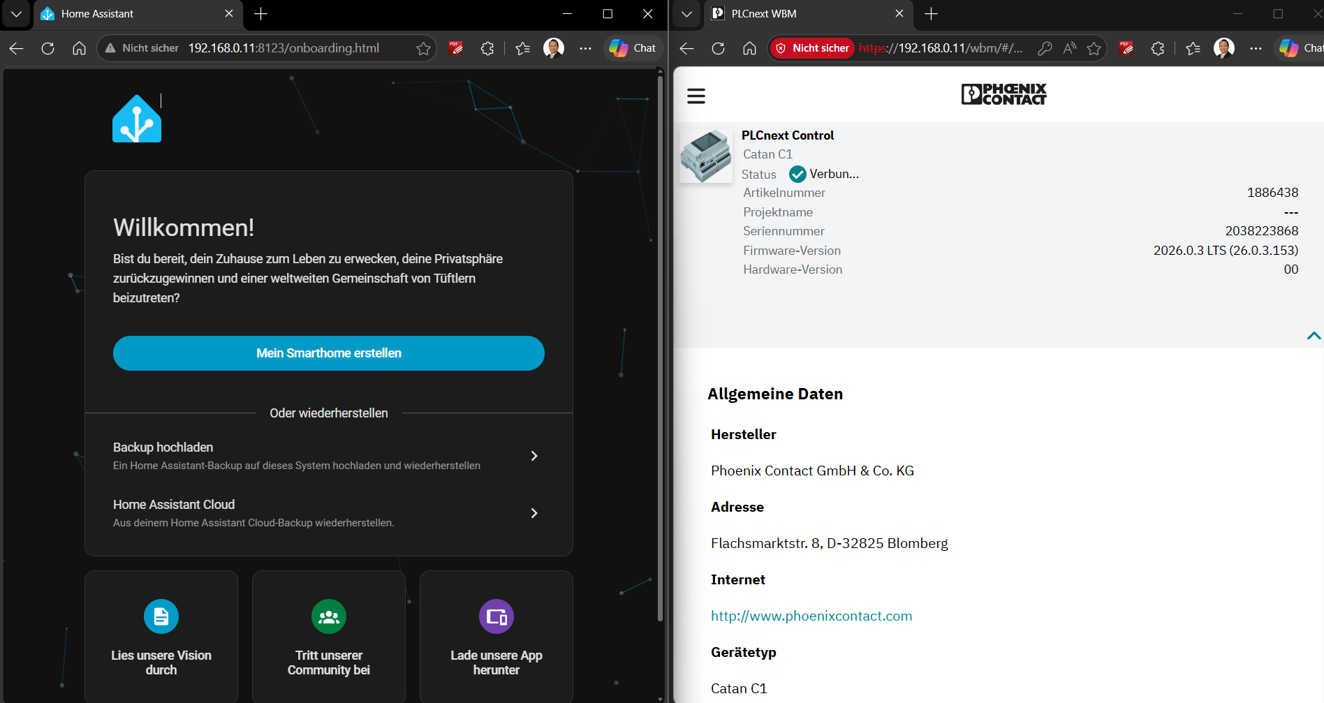

The first startup may take a few minutes while the image is downloaded and initialized.
Access Home Assistant
Once the container is running, you can access Home Assistant in your browser:
http://your.IP//:8123

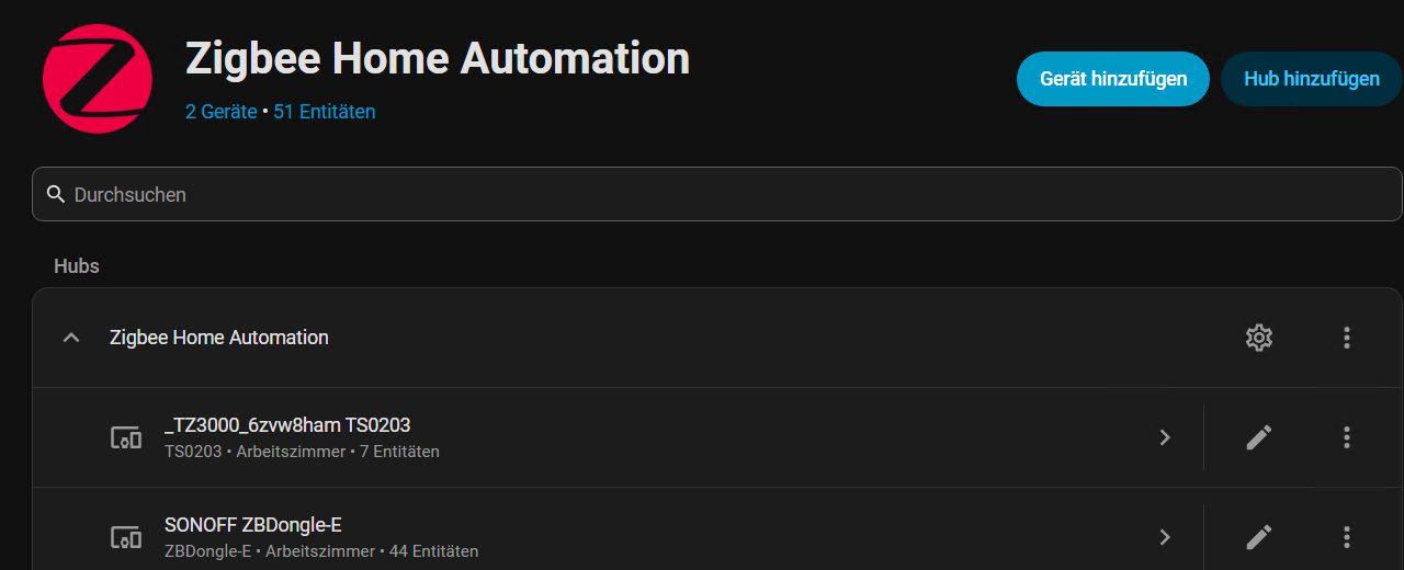

Bonus::electric_plug: Zigbee Stick Integration
Verify USB Device Mapping
All USB devices are exposed under:
/dev/usb-devices
To identify your Zigbee stick, run:
ls -l /dev/usb-devices/symlinks/
Example output:
lrwxrwxrwx 1 app_user plcnext 16 Jun 12 11:07 usb-ITEAD_SONOFF_Zigbee_3.0_USB_Dongle_Plus_V2_20221129211414-if00 -&gt; ../nodes/ttyACM0
:backhand_index_pointing_right: Important: The device name will differ depending on your hardware.
Configure Zigbee in Home Assistant
After logging into Home Assistant:
Go to Settings → Devices & Services
Add a new Zigbee integration Use the correct device path, for example:
/dev/usb-devices/symlinks/usb-ITEAD_SONOFF_Zigbee_3.0_USB_Dongle_Plus_V2_20221129211414-if00
For the Sonoff Zigbee Dongle E, use:
EZSP driver
Software data flow
:chequered_flag: Final Result Once everything is configured:
Your Zigbee network can be initialized Devices can be paired and controlled Automation workflows can run locally on the Catan C1

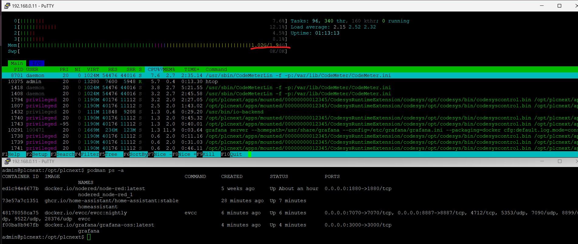

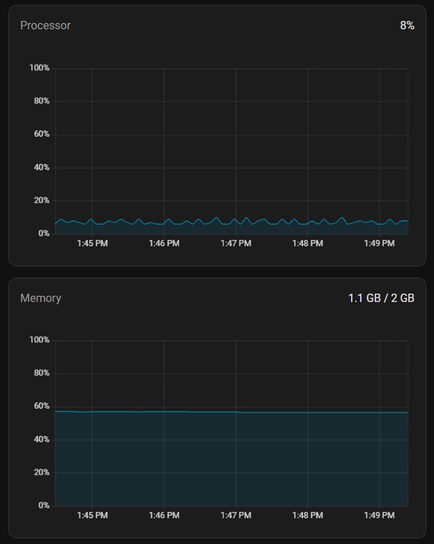

You’re completely right that 2GB RAM can feel tight on paper, especially when running multiple containers. However, in practice, it’s handling the load surprisingly well.
Currently, I’m running several parallel containers alongside Home Assistant, and RAM usage sits comfortably at around 1.1 GB (roughly 55%) — I’ve attached a screenshot below to show the stats.
