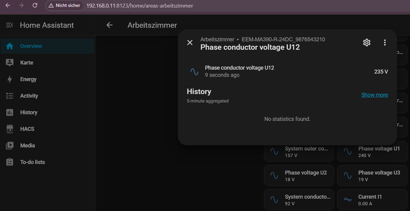

Installation HACS & BACnet/IP on Phoenix Contact Catan C1 over podman to get BacNet Data from EMpro EEM-MA390-R

Note on Container Updates: When updating your Home Assistant Podman image (podman pull), the container layer is recreated. After upgrading the HA container, simply re-run Step 3 (pip install ...) and restart the container if HA asks for the dependencies again.
Disclaimer / Disclosure: I received this hardware as a sponsored unit. For those looking to buy one, it is currently available (at least in Germany) through major electrical wholesalers (Elektrogroßhändler).
Feel free to ask any questions regarding the container setup, the hardware, or the BacNet configuration below!
