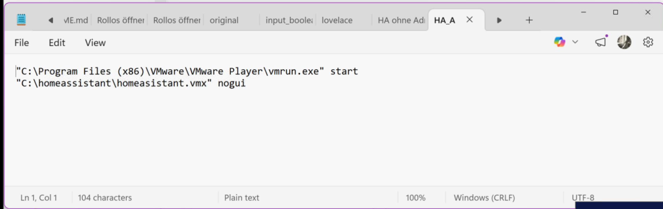

If I may ask, how do you let HA run again after an automatic update? I am running the same setup as you but with oracleVM. Tried turning off all automatic windows updates but cant get arround this it seems…
I guess you mean updates that end in an automatic reboot?

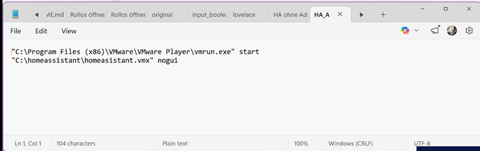

I wrote a little batch file called HA_autostart.bat with the following lines:
And then I made a task in the windows task scheduler to run that batch file at every system start - even when I am not logged in.
