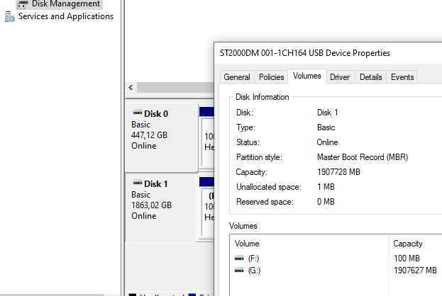

Take the disk, and connect it to a windows machine via USB
Go to Computer-management / Disk-Management in windows and click on the Disk(i.e disk 1, or what it turns up as, Right-click under the name there, Choose Properties then Volumes ( Partition Style )
As You see this is my disk1, which i use for “storage”, they quite often ends as an MBR disk, so they can be used/accessed everywhere.
As you say your BIOS don’t have the “Legacy” Option fut this could be a reason for the UI not showing it( it might be an MBR"legacy-Not-UEFI" , ( Which doesn’t Support i.e SecureBoot )

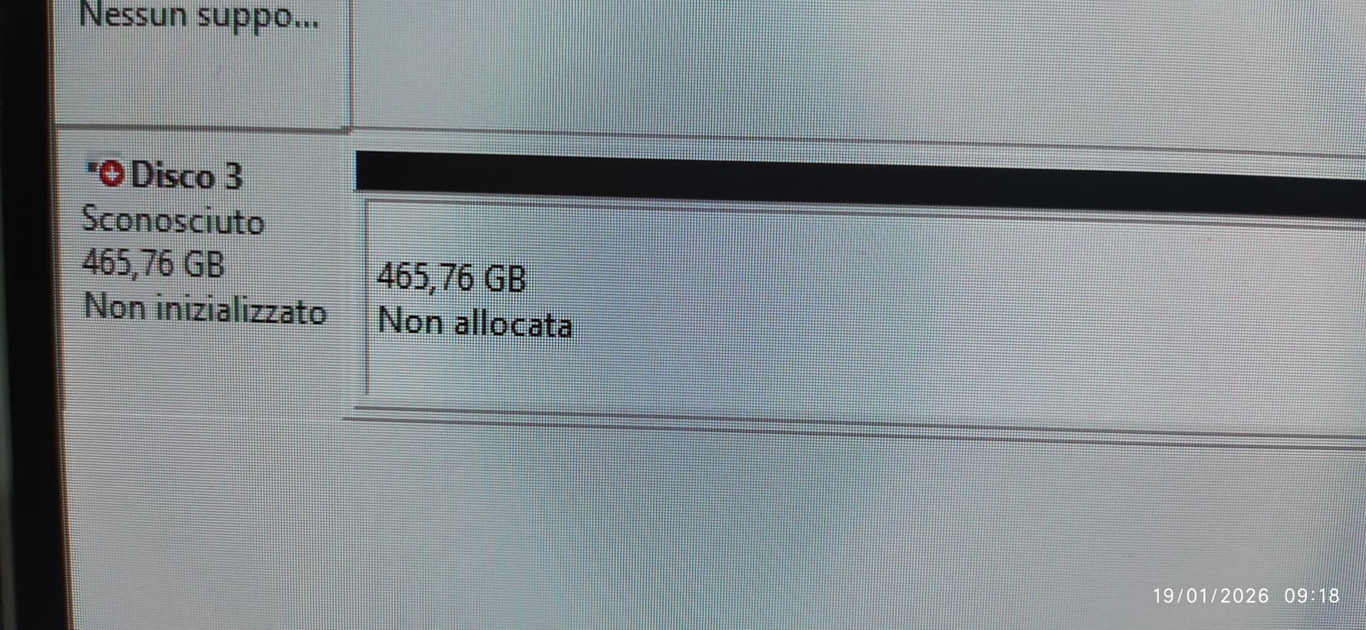

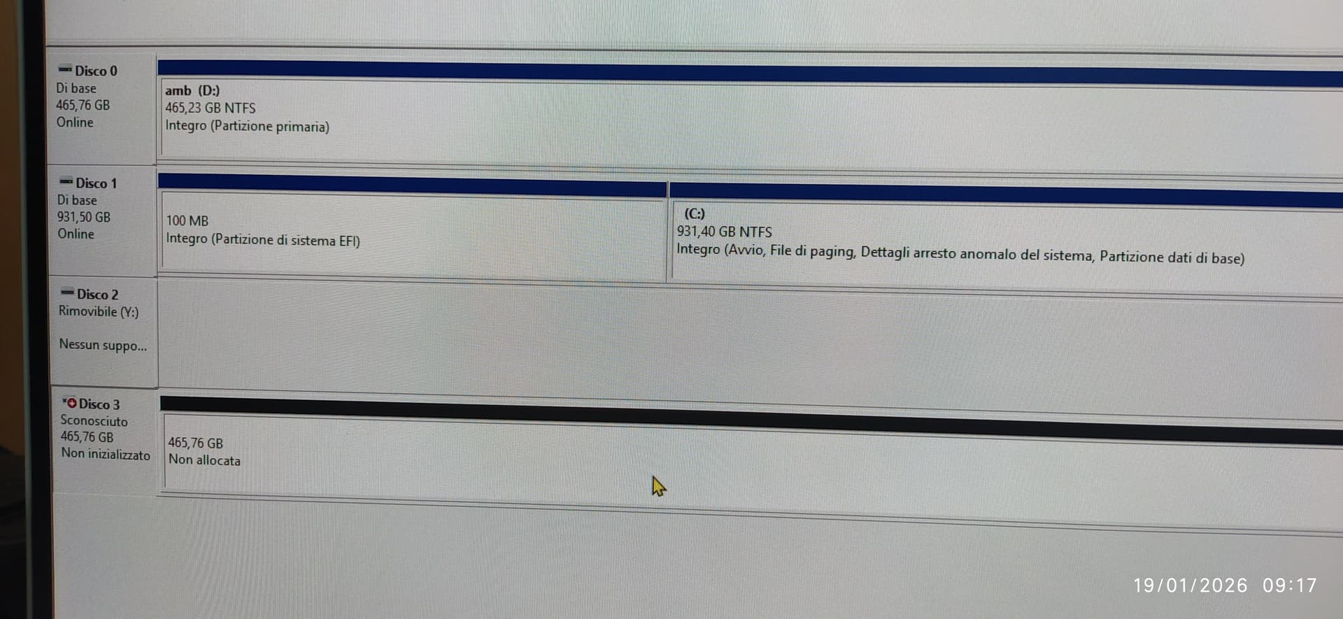

? did you install windows on the disk now ? ( sorry i dont understand the language )
Ahh ok, i guess it’s disk 3
Have you converted to GPT ?
right-click to the left, under the name of the disk, how does that popup look now ?
You have to “Initialize” the Disk ( after converting )
Same right-click the disk-name ( I think thats what the pic says “Not Initialized” )
seriously what are you doing, now you’ve post 2 pics, and NO commends, and no answers in regards what you have done.
Are you trying to piss me of ?
sorry but the forum does not allow me to send pics more than one… I must wait 5 minutes in between and was not at home.

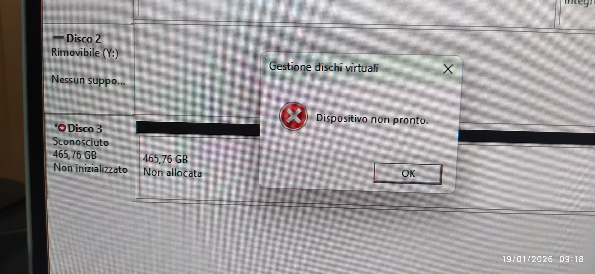

At the end Disk Manager says that the “device is not ready”. Ican NOT perform other action on the HD. Thanks
And have you tried this ?
Hi Boheme, when I try to convert to GPT it says that " device is not ready ".

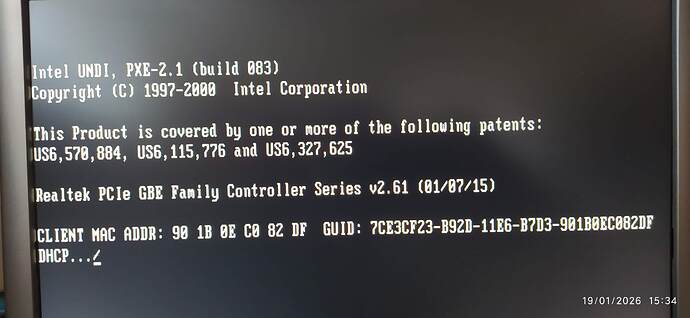

At the moment the HD in the windows desktop nor in the mini PC USB port. The next pic is what the mini PC says now when try to boot from the HD .
At he moment : if I connect the HD to the mini PC USB port I have the previous pic . It is very strange ! Could be that the mini PC has some lockup in the firmware or there is something that corrupt the HD . There is no way here to recover the HD .
windows disk manager does not allow me to perform any action on the HD.

What your pic shows is that your Device is trying to boot from the Network-card, maybe because this is in top of the boor-order, or because there is no USB, Nor Disk BOOT devices available ( Most likely the case )
As your DISK was NOT Initialized it wont show up as a BOOT device

YES: I did what you told me: I did connecte the HD to the windows desktop PC using a SATA to USB adaper , I did launch the Disk Manager , I did right click on the HD ( disk 3 ), I did press OK on the initialize disk and I got the " device not ready " message very soon .
