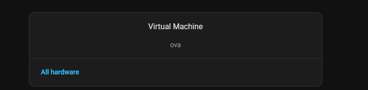

Installation now thinks its an OVA not Native x86
Hi

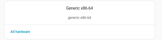

I have been running HA on bare metal for many years, and after an update back in july timeframe, the installation states its runing as an OVA and not bare metal x64.
I have just installed a new SSD and post native install, it shows x64 however, once I restored my backup - it reverted to OVA!
How can I get HA to realise its bare metal?!?!

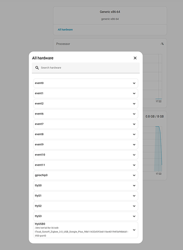

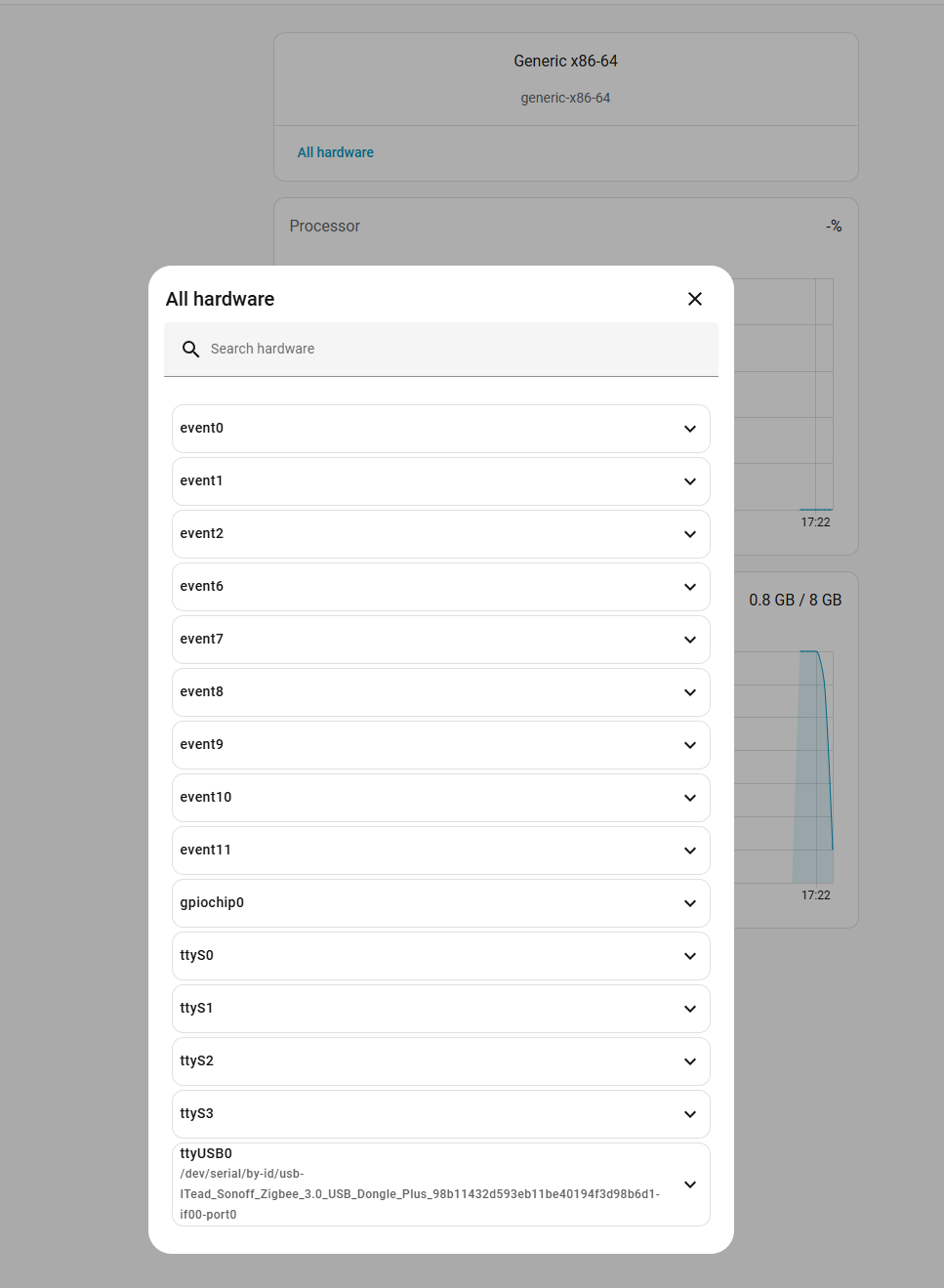

The main issue I have with this is that all the native USB devices fail to work as they dont make it over to the “vm”.
Thoughts?

Where do you see it thinks it is running in a vm ?
In system…
From the command prompt os info sates “board: generic-x86-64” which is correct…
My issue is that USB devices dont appear… plus, its not a VM…

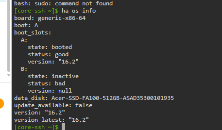

Hi… ok, wiped and reinstalled the image… see below - shows USB device and “generic x86-64”… did NOT restore backup.
HI…ok, rebooted a couple of times and it remained as native x86.

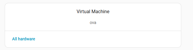

I then changed the IP address from dhcp to static, and then it immediately shows ova again!
Thoughts?

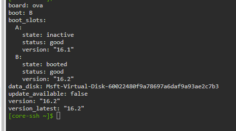

As requested… this was run once it changed to ova…(obviously!)
note disk thinks its an ms disk when its a physical 512gb nvme disk.

I did a restore from a known good physical backup…and it was back to showing OVA.
Rebooted…and low and behold…its showing physical again…
…os info shows…
Restarted from within HA, and back to OVA!

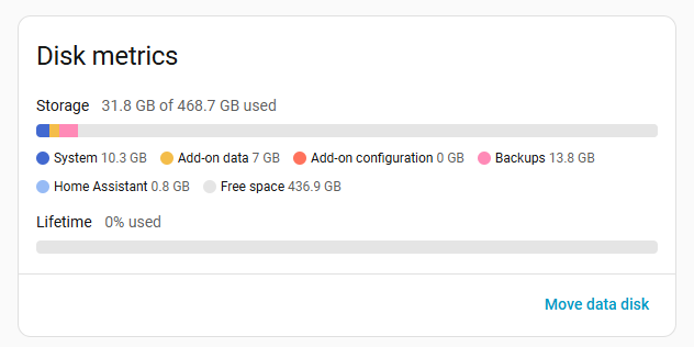

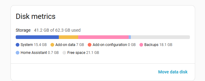

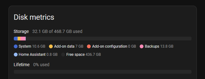

NOW…here may be a big clue…so need to investigate…when looking at disk, the geometery of the partitions have changed…see below … disks when booting as a VM…
Seems like the box is booting from physical disk…then somehow booting from a VM disk…
See disk blow when booted as physical hardware.

Ok Folks…
Boot from Slot A - the world is good - showing physical and disk full capacity
Boot from Slot B – bad news - showing OVA and a small drive.
Is there any safe way to recover from this? - like copy Slot A over B?
