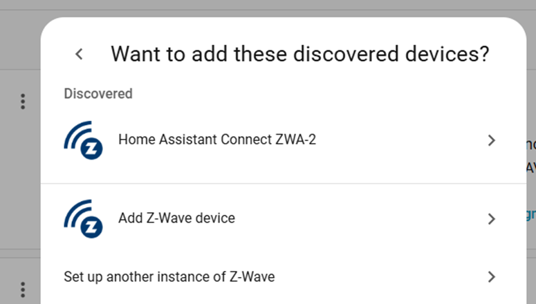

I would love to check a box, but their is no box. I start here …

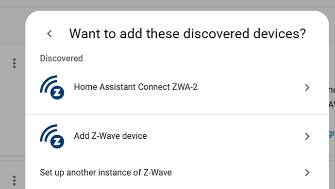

After selecting the ZWA-2 I get this …

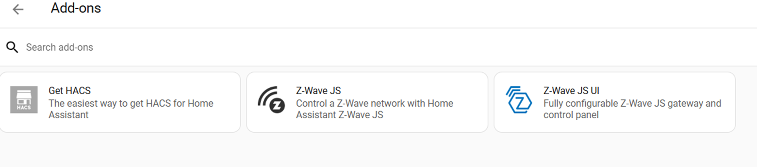

It does not matter which I select, I then end up with the following

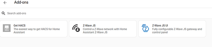

And after a few minutes I get …
The ZWA-2 device is not added, but the zwave JS addon is installed when I check the add-ons…
Stop choosing the discovered adapter, instead choose “Set up another instance of Z-Wave”. Then pick the custom installation.
The discovered adapter selection will always install the core add-on, that’s its purpose. The custom installation section for that is pretty misleading as a result.

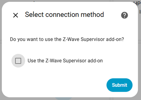

Thanks freshcoat. Selecting “set up another instance of Z-wave” was not an obvious choice to me. After selecting the custom installation I got the following prompt and I unchecked the box.
From their the instructions were accurate again. I would suggest that the instructions are “improved” to make this more clear. While I am a newbie to HA, I don’t think the instructions are clear enough to successfully navigate.
