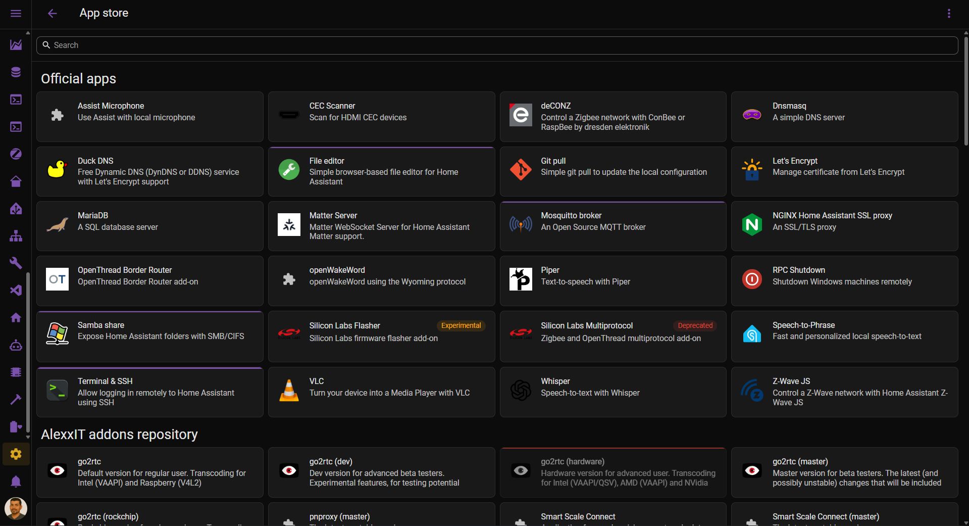

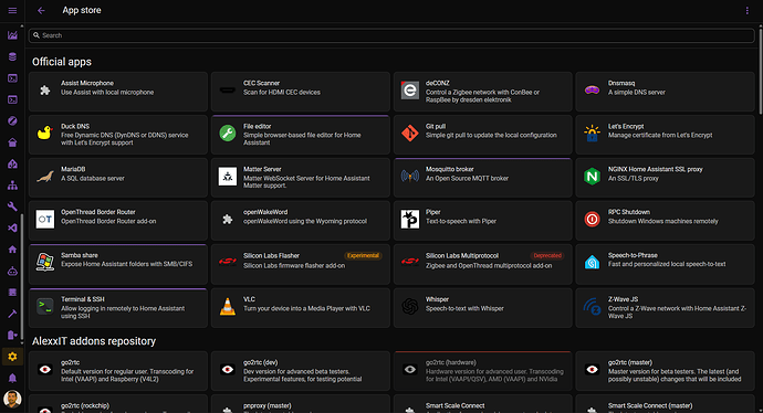

What is the store/shop? Node Red is available under >Settings >Apps (formerly add-ons)
Clicking Install App bottom right will get you to the App Store.

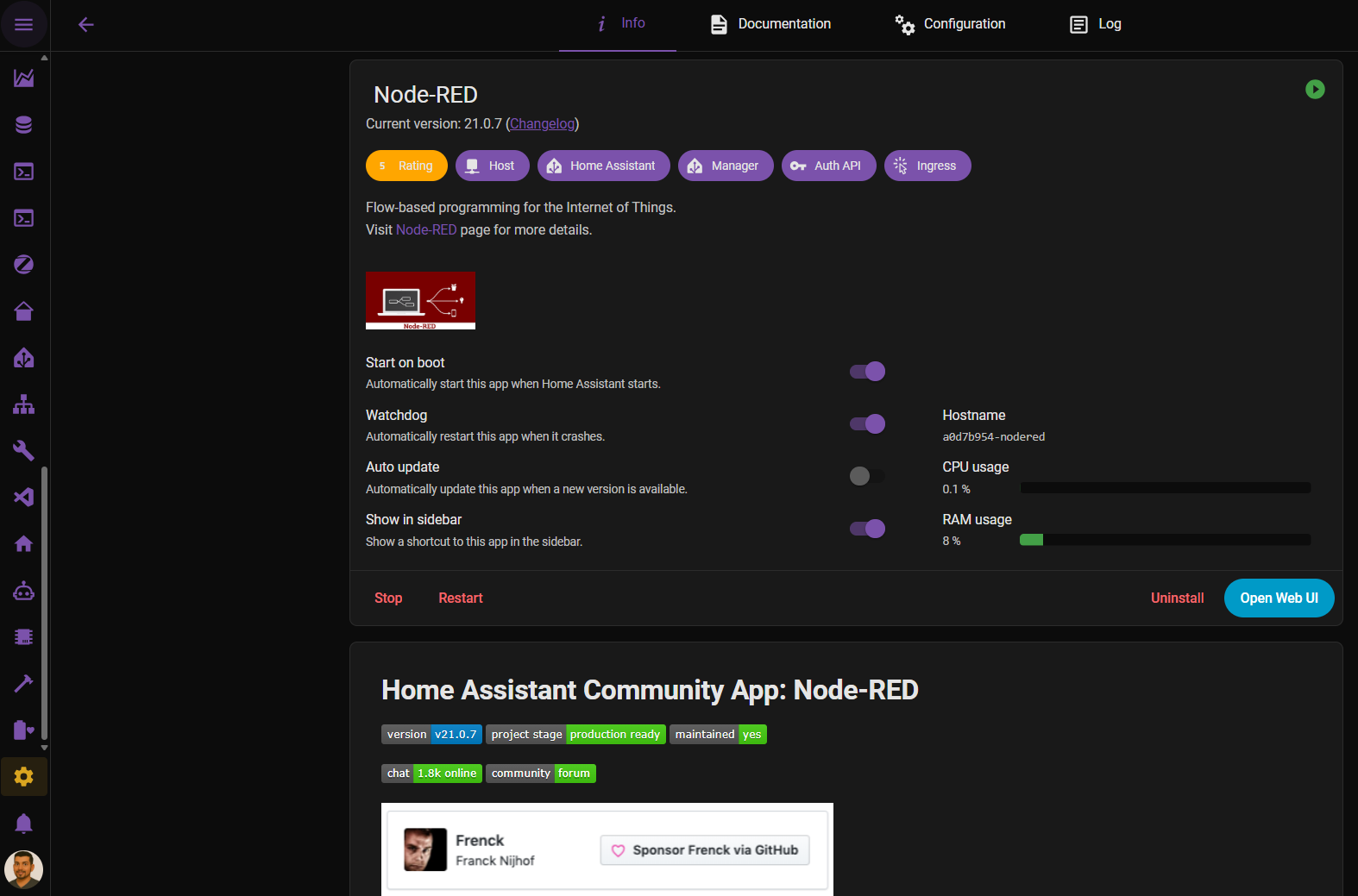

Opening NodeRED from >Settings >Apps make sure you select watchdog and show in sidebar. The icon will show in the sidebar for NodeRED

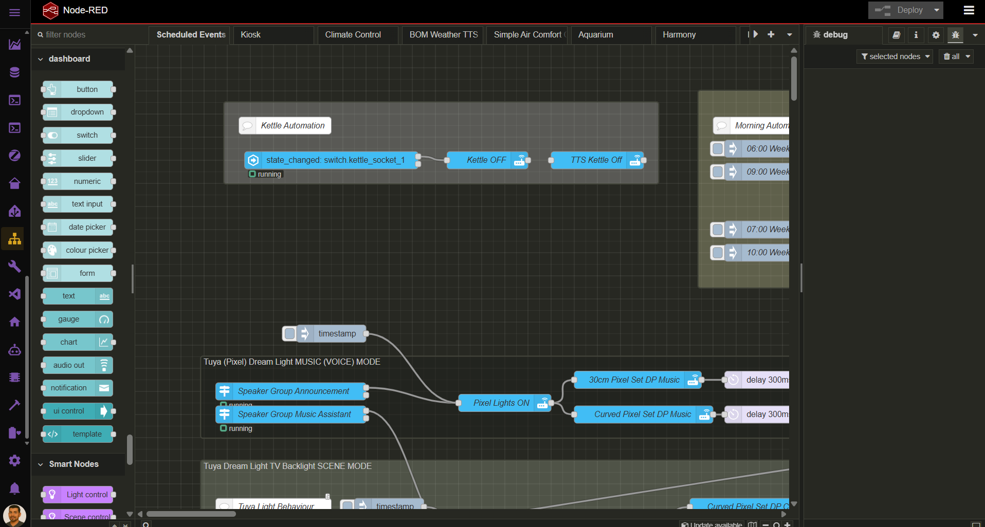

Once you have NodeRED open then you can create a NodeRED dashboard using the dashboard nodes.
A NodeRED dashboard is different to a HA Lovelace Dashboard. Accessible in a different way and not as pretty as a HA Lovelace Dashboard.
I would recommend NodeRED for Automation Flows and HA Lovelace Dashboards for your GUI.
NOTE: The yellow icon in the below picture is the NodeRED sidebar icon.
