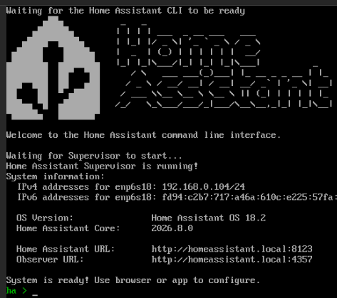

So it looks like this?
http://192.168.0.104 or http://192.168.0.104:80 do either of these work?
Hi Michael, if you connect a display to that system you should get what @fleskefjes is showing but with the IP settings for your network.
Use the IPv4 address, make sure you use http://… (not httpS://) and normally you should not have to use a port since with the latest release, new installations listen on port 80.
You could also try with http://homeassistant.local (also without a port, not as in that screenhot)
