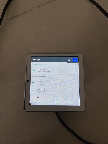

Jailbreak Using Developer Settings
I just found this way - I hope I have not forgotten any relevant step.
This guide explains how to enable Developer Settings and install any app.
[!CAUTION]
The Developer Settings are not designed for regular consumers.
Changing these settings can lead to bricking your device. Proceed with caution!
Enabling Developer Settings ( as described by [RapierXbox] (RapierXbox (RapierXbox) · GitHub))
Access Device Information
Navigate to:
Settings → General → About Device
About Device
Activate Developer Settings
On the About Device screen, you will see the texts indicating (H)ardware revision and (F)W version. Tap them in the following order:
F, H, F, F, H, F, H, H
Now to the new part:
Scroll to the bottom of the developer options and select: open Android settings
in Android settings:
  • goto Security and enable Unknown sources
  • goto Apps Browser and enable all permisions for the browser
  • still in app info select “browser app” and select the browser as the browser app
  • in Apps select the “3 dots” in the top right corner and select show system
  • scroll down to “html Viewer” and select it allow all permissions (only storage)
  • still in settings goto “About tablet” - “Legal information” - “System view licenses”
  • On the license page click on a link.
  • select the browser to open the linkthe browser opens
  • navigate to Shelly elevate release page
  • download the “ultra-small-launcher.apk”
  • install the apk
  • press the shelly logo to go back to the shelly app
  • go back into the android settings
  • goto apps - laucher - set “Home app” to yes
  • press the shelly logo you now in the laucher.
  • you can now install shelly elevate
  • or any other app for example the home assistant app

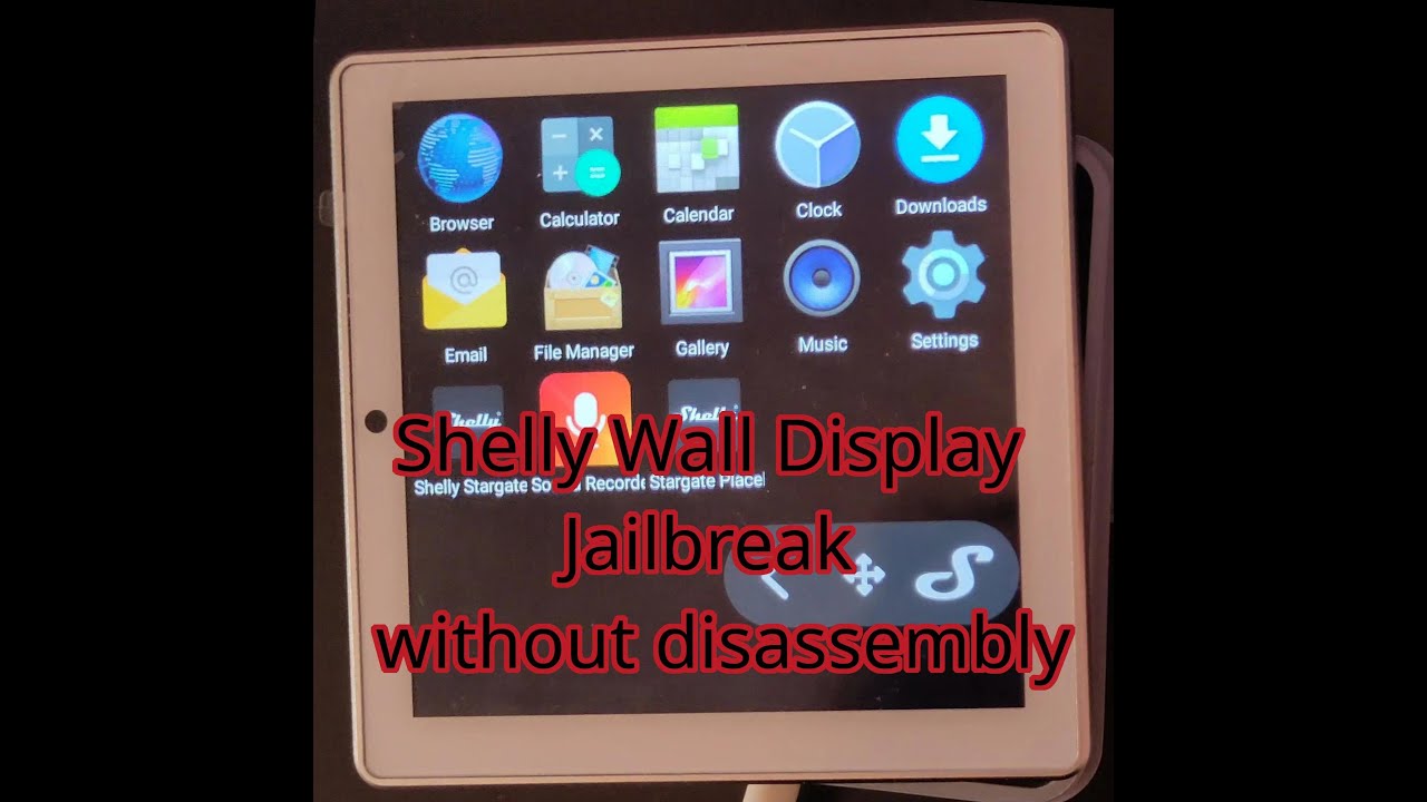

Shelly Wall Display - Jailbreak - without disassembly
Video of the Jailbreak
Do you know if there’s a way to do this with the XL? I can’t find the same options in it.
They have locked us out now by making the software buttons cover the 3 dots
If you turn on Force RTL in Developer settings the dots become accessible
