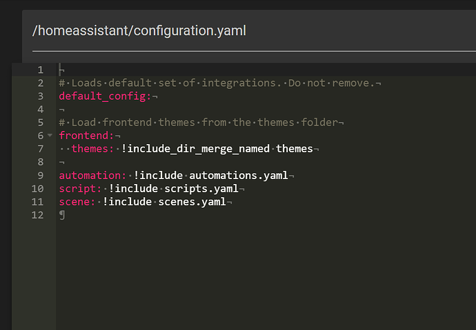

  2. Two settings are needed in configuration.yaml, not just the quirk file itself (note that if you already have a zha: section, you must add this info in that same section):
yaml
   zha:
     enable_quirks: true
     custom_quirks_path: /config/zha_quirks/
adjust the path to wherever you put the quirk file, followed by a full Home Assistant restart - not just a reload of ZHA.

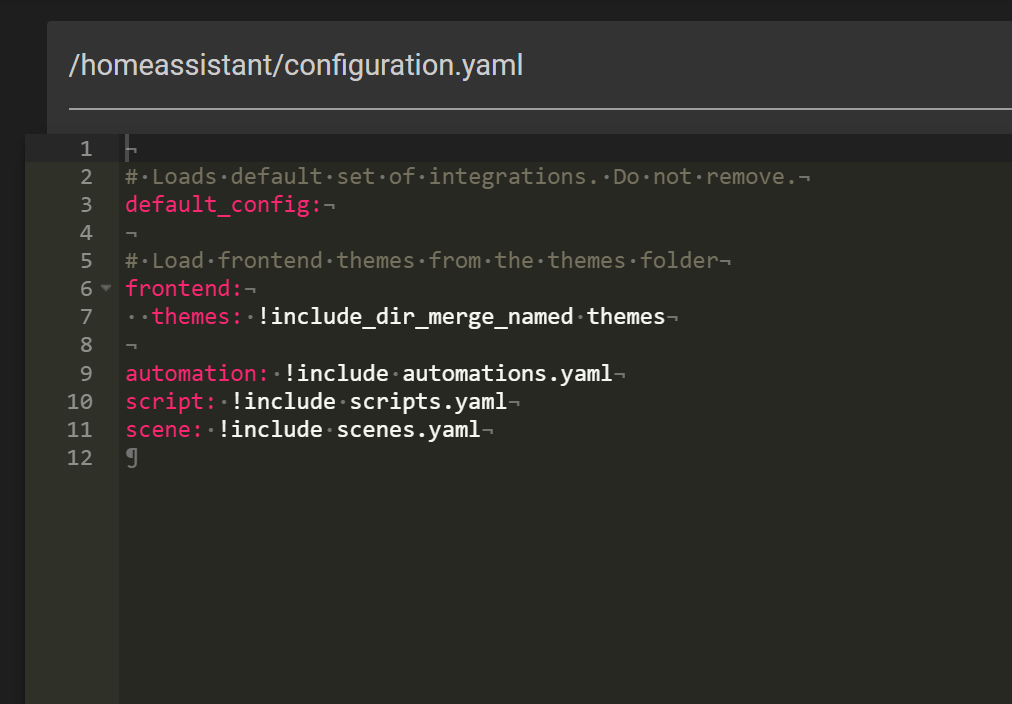

is this the correct file i need to edit??
