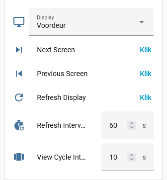

I see 2 devices in HA as well, I’m just ignoring the one with the 1 entity. I had to wiggle a bit with the buttons and settings to get it working, but it looks good now. These buttons:

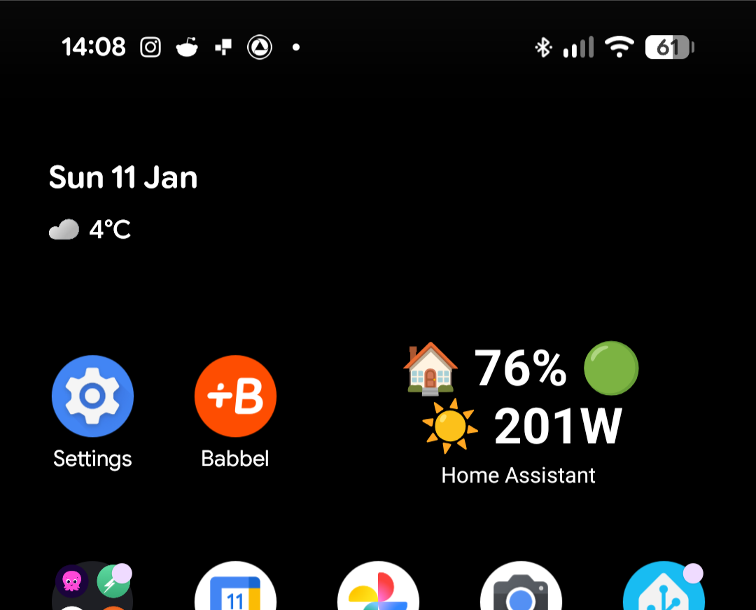

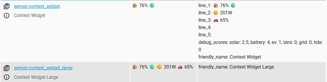

Cheeky question - is there any plan to support Unicode/emoji characters? I’ve been working on an automation that creates a multiline, context sensitive widget for my Android phone, and it makes much use of emojis to keep the info as compact as possible. Making this also display on the GeekMagic box feels like a really good fit for it. When I tried the relevant sensor, it isn’t able to display the unicode characters though. It is of course entirely possible I need to make some config change to enable this!
