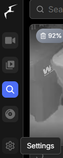

If your Frigate installation starts with the standard/sample configuration you can also edit its config.yaml file by goin to the Settings - Configuration Editor menu option:
