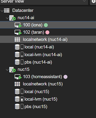

Thats exactly what these two little boxes are doing:
The NUC14 is hosting:
  • Iona, a vm which runs a bunch of base home lab containers that don’t need heavy compute or any GPU it also has an NVidia 5700ti punched through to it to ollama
  • Taran, another vm - this time with an onboard iGPU (Intel a770xe) punched through to a SECOND instance of ollama (effectively, different serve) this one has more vram but slower silicon,
The Nuc 15 is hosting my HA instance.
The VMs easily could be on any of the hosts, and I have temporarily run homeassistant on the same box running taran and iona when I had a hw failure on NUC10 (the predecessor for NUC15, and yes i had to punch through the USBs to the host as well and move my dongles)
