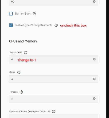

EDIT: Looking at your VM setting - I also recommend the following changes.
There’s nothing wrong with having loads of CPU HAOS, but unless you know it’s needed, you can also reduce the number of threads to free up resources for TrueNAS.
