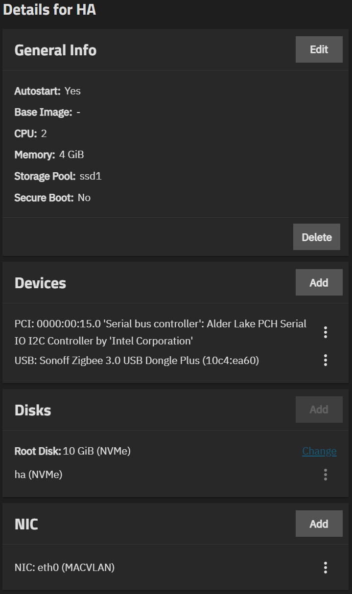

Hi everyone. Great thread! I’m new to TrueNAS and HAOS, but I installed it without a hitch using the instructions here. My only problem is getting Zigbee2MQTT to work.
TrueNAS SCALE: Fangtooth 25.04
HA Core: 2025.7.2
Zigbee dongle: Sonoff Zigbee 3.0 USB Dongle Plus
TrueNAS “Instances” VM for HAOS
*** HAOS Settings ***
Under Devices & services > Integrations there are 2 related items:
1) MQTT > Mosquitto broker 6.5.1
      Broker: core-mosquitto
      Port: 1883
      Username: mqtt-user
      Password: ****************************
2) Zigbee Home Automation > Sonoff Zigbee 3.0 USB Dongle Plus
      > CC2652 by Texas Instruments, firmware: Z-Stack 20240710
      radio type: znp
      serial port: /dev/serial/by-id/usb-ITead_Sonoff_Zigbee_3.0_USB_Dongle_Plus_fe3158e2c46bef11bc6897adc169b110-if00-port0
      baudrate: 115200
Under Add-ons there are 2 related items:
1) Mosquitto broker 6.5.1
2) Zigbee2MQTT 2.5.1-1
      data_path: /config/zigbee2mqtt
      socat:
            enabled: false
            master: pty,raw,echo=0,link=/tmp/ttyZ2M,mode=777
            slave: tcp-listen:8485,keepalive,nodelay,reuseaddr,keepidle=1,keepintvl=1,keepcnt=5
            options: "-d -d"
            log: false
      mqtt:
            server: mqtt://core-mosquitto:1883
            user: mqtt-user
            password: ****************************
      serial: (blank)
Zigbee2MQTT Onboarding:
Found Devices: usb-ITead_Sonoff_Zigbee_3.0_USB_Dongle_Plus_fe3158e2c46bef11bc6897adc169b110-if00-port0 (ITead), /dev/ttyUSB0, zstack
Coordinator/Adapter Port/Path: /dev/ttyUSB0
Coordinator/Adapter Type/Stack/Driver: zstack
Coordinator/Adapter Baudrate: 115200
Coordinator/Adapter Hardware Flow Control ("rtscts: true"): No
Closest WiFi Channel: 6
Network Channel: 11
Generate network? No
MQTT Base Topic: zigbee2mqtt
MQTT Server: mqtt://core-mosquitto:1883
MQTT User: mqtt-user
MQTT Password: ****************************
Frontend enabled? Yes
Frontend port: 8099
Home Assistant enabled: Yes
Log Level: info
Zigbee2MQTT log onboarding results
[2025-07-15 13:57:28] info: 	z2m: Logging to console, file (filename: log.log)
[2025-07-15 13:57:28] info: 	z2m: Starting Zigbee2MQTT version 2.5.1 (commit #unknown)
[2025-07-15 13:57:28] info: 	z2m: Starting zigbee-herdsman (4.3.1)
[2025-07-15 13:57:28] info: 	zh:adapter:discovery: Matched adapter: {"path":"/dev/ttyUSB0","manufacturer":"ITead","serialNumber":"fe3158e2c46bef11bc6897adc169b110","pnpId":"usb-ITead_Sonoff_Zigbee_3.0_USB_Dongle_Plus_fe3158e2c46bef11bc6897adc169b110-if00-port0","vendorId":"10c4","productId":"ea60"} => zstack: 4
[2025-07-15 13:57:28] info: 	zh:zstack:znp: Opening SerialPort with {"path":"/dev/ttyUSB0","baudRate":115200,"rtscts":false,"autoOpen":false}
[2025-07-15 13:57:28] error: 	z2m: Error while starting zigbee-herdsman
[2025-07-15 13:57:28] error: 	z2m: Failed to start zigbee-herdsman
[2025-07-15 13:57:28] error: 	z2m: Check https://www.zigbee2mqtt.io/guide/installation/20_zigbee2mqtt-fails-to-start_crashes-runtime.html for possible solutions
[2025-07-15 13:57:28] error: 	z2m: Exiting...
[2025-07-15 13:57:28] error: 	z2m: Error: Error Resource temporarily unavailable Cannot lock port
[13:57:28] INFO: Preparing to start...
[13:57:28] INFO: Socat not enabled
[13:57:28] INFO: Starting Zigbee2MQTT...
Starting Zigbee2MQTT without watchdog.
Onboarding page is available at http://0.0.0.0:8099/
I’ve looked at several different websites and hours of YouTube videos and tried many different combinations, including direct configuration instead of the Onboarding tool, but no dice. :frowning: Is anyone out there using the current versions of TrueNAS Scale Instances and HAOS with Zigbee2MQTT?
As a new user, I can only post 1 screenshot per post. Let me know if there are any other settings are needed. Thanks!
LOL - I typed all that out and I figured out the problem.
Under Devices & services > Integrations, I had to disable the “Zigbee Home Automation” integration.
It’s working! :tada:

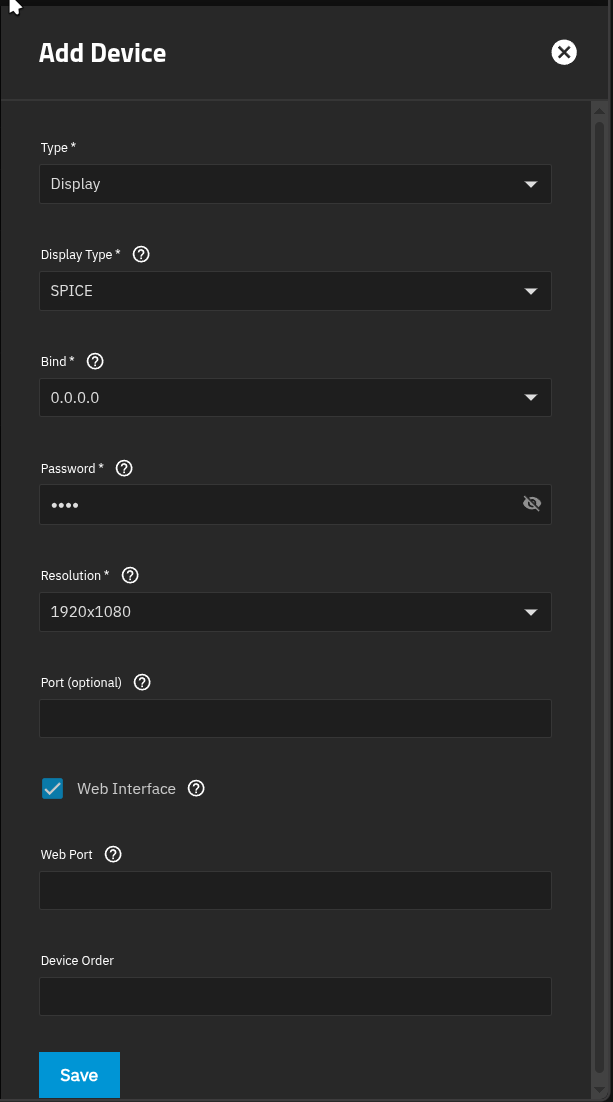

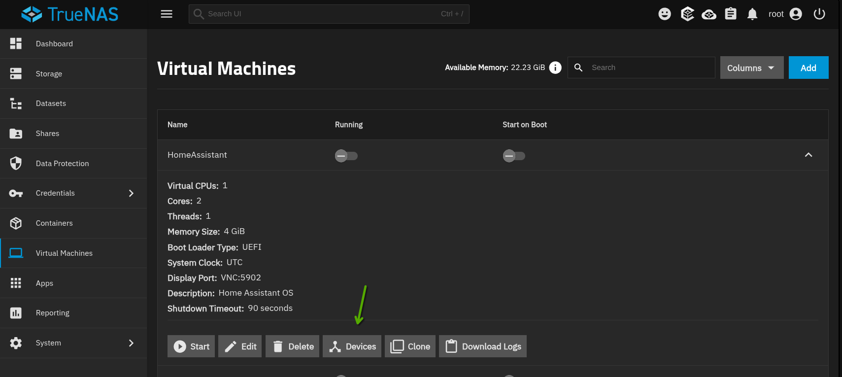

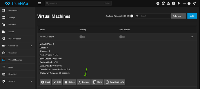

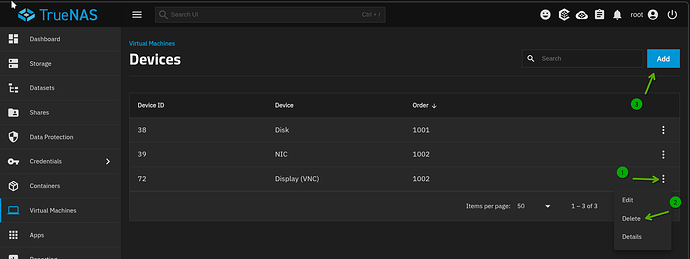

That’s not an error message. It is telling you that a VNC Display is Available and to connect using a VNC client.
TrueNAS no longer opens the VM’s VNC connection in the browser. You’ll need to use a VNC client on another computer. In the VNC client, enter your TrueNAS IP and use port 5900.
For example, on Windows you might use TightVNC or RealVNC Viewer.

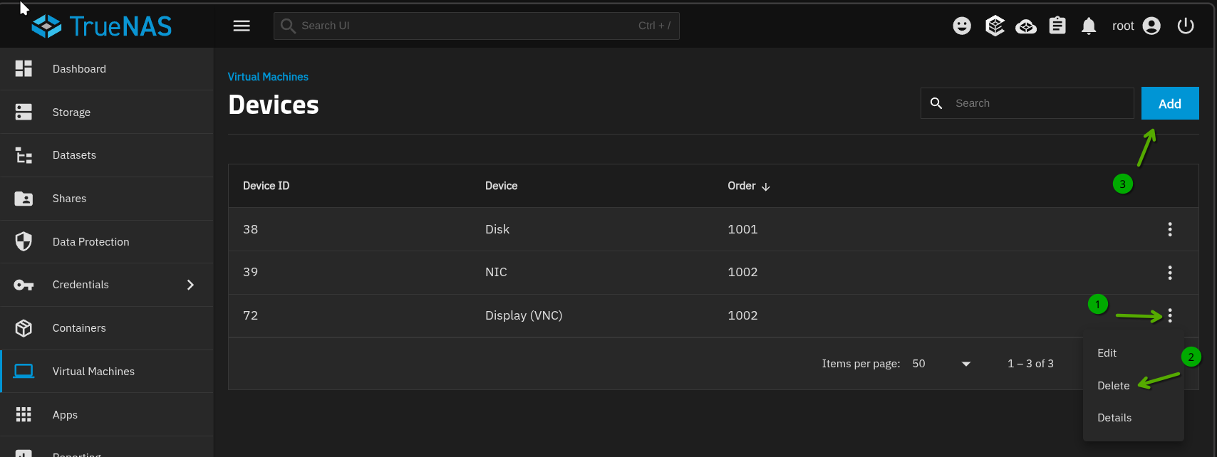

Alternatively, if you want the VM’s display to show in the web browser, you can use a Spice display. First, stop your VM, then click Devices
If you’re not going to use the VNC display, you can delete it from the three-dot menu. Click the Add button in the top right corner to add a Spice display.
Adding the Spice display is straightforward. Set the Type to Display and the Display Type to SPICE. Bind can be either 0.0.0.0 or your TrueNAS IP. You have to set a password, but it can be as little as one character. Finally, ensure the Web Interface box is checked and click Save.
That’s it! Now, the Display button should open the HAOS terminal in the web browser.
