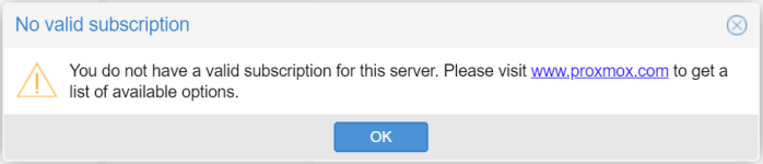

What is the current method to disable the nag screen ?
There were some updates, I installed them and the nag screen is back.
Ok, running that again :slight_smile:
If you want to do it manually (from my notes, had the same thing yesterday…):
  1. Change to working directory
    cd /usr/share/javascript/proxmox-widget-toolkit
  2. Make a backup
    cp proxmoxlib.js proxmoxlib.js.bak
  3. Edit the file
    nano proxmoxlib.js
  4. Locate the following code
    (Use ctrl+w in nano and search for “No valid subscription”)
Ext.Msg.show({
  title: gettext('No valid subscription'),
  1. Replace “Ext.Msg.show” with “void”
void({ //Ext.Msg.show({
  1. Restart the Proxmox web service (also be sure to clear your browser cache, depending on the browser you may need to open a new tab or restart the browser)
    systemctl restart pveproxy.service

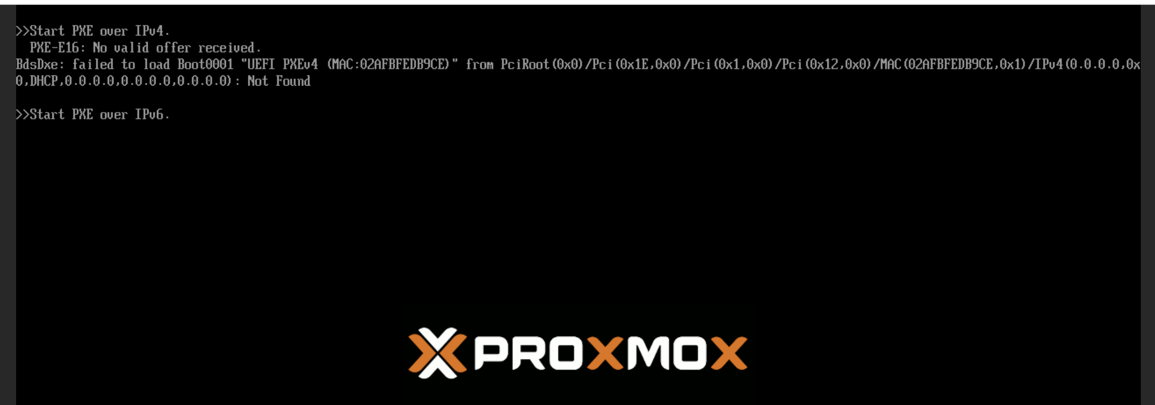

Did not work for me. No IP address obtained. See this in the console:
Start PXE over IPv4
PXE-E16: No valid offer received.
BdsDxe: failed to load Boot0001 "UEIF PXEv4 (MAC:02AFBFEDB9CD)" from PciBoot(0x0)/Pci (0x1,
Running Proxmox 8.2.2
