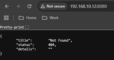

and when I try to access the otbr web interface, I get this
Has anyone ever done what I’m trying to do? Or do you know what could I be doing wrong?

Actually, your REST API seems to be runnning. The 404 response on your GET request to 192.168.10.12:8080 is correct.
You should be able to add this exact URL in the OpenThreadBorderRouter integration in HomeAssistant.
If everything else is correctly configured, the Thread integration should show a network and this border router as default border router.
