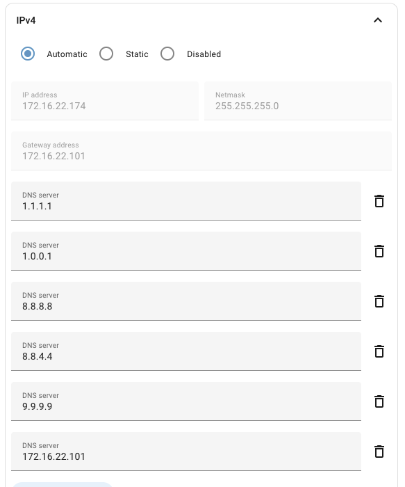

So those DNS servers are a combination of Google and Cloudflare? I’ll give it a shot.
Wait, it gets better. I added some more DNS servers and restarted HA. Now It’s telling me:

Try this: How to set DNS after first install
Here’s my current DNS setup. Are you saying I should ditch all but 9.9.9.9? Who is that, btw?
No not at all.
That topic does not apply to you, as noted in the topic:
I was under the impression that this was a first installation issue and you could not get the HA frontend up and running.
Do you have a pi-hole or AdGuard DNS filter on your network?
