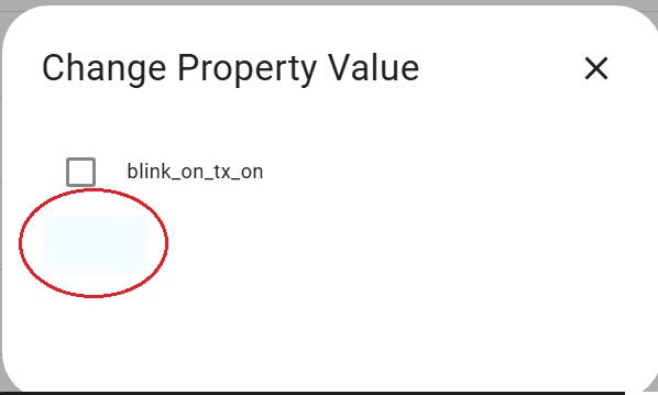

I’m trying the update the properties one of my Insteon keypads. I’m able to open the device configuration page and can click on the propetry I want to change but, when I select the new value, the screen flips back to the list of all devices. I’m unable to select “write to” for any device.
Am I doing something wrong?
I am having the same problem. Something must have broken in the UI.
The buttons to confirm your change in the device properties appear to be hidden. This is an obvious bug. But you can still click them, then select “write to device” and all is good. Below the check mark of property you are trying to change, hover your mouse around and you will see these hidden buttons appear very faint with no label. You will want to click on the button to the far left to apply your property change. Then you can write the change to the device.
