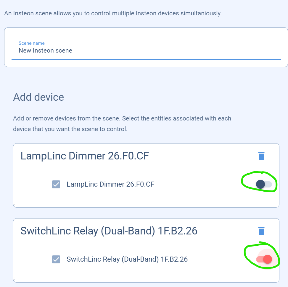

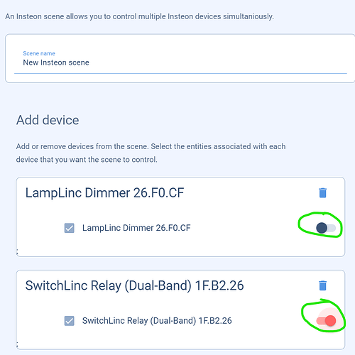

In the Insteon Control Panel I am trying to create scenes. However, I do not see how I am supposed to designate which are controllers, responders or both. ChatGPT says there should be a configuration panel where I have checkboxes for Controller and Responder… but I can’t find them anywhere.
@teharris1 - Am I missing something here or is the integration not working properly for Insteon? (See my post above.)

I have a PLM and only 7 devices (1 LampLinc dimmer and 6 SwitchLincs) but none of them are in use now since moving/downsizing. Plus now, most of my very few light switches have a neutral in the box. I’ve never used scenes so I can’t really assist as to why this integration’s panel doesn’t allow for controller/responder input but am wondering if this the responder/controller setting?

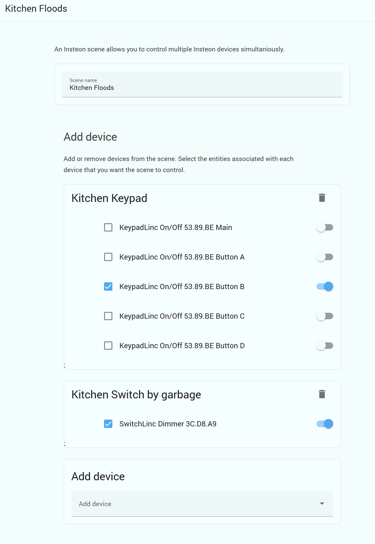

Unfortunately, I don’t think this integration fully supports programing controllers and responders like we’re used to with the ISY or Insteon Hub. We can make scenes that are triggered in Home Assistant, but we have to manually link a button to control a switch.
None of my scenes are showing up in HA either, so I can’t select them to add to an automation.
For devices I manually add into HA, I can see their status and control them.
