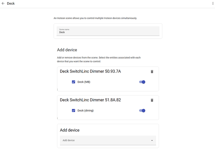

I interpret this to mean: Settings–>Insteon
I’m not seeing how this is done.
If I go to Settings–>Insteon–>Insteon Scenes–>[Deck] I see this scene:

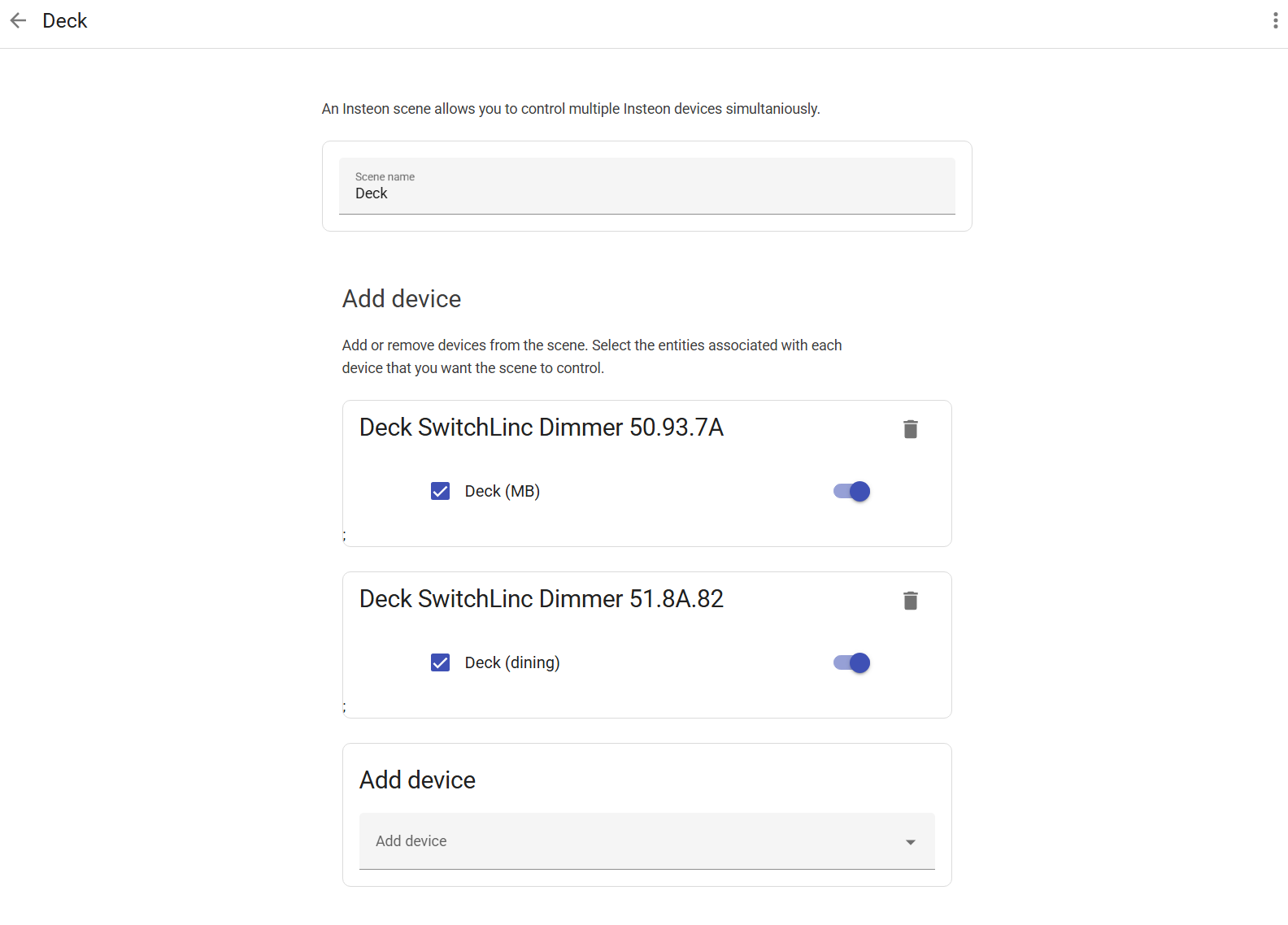

Then I had the idea: “change one of the entries, then change it back, then save it.” voila! it now works.
Update: When editing the scene, all the devices that you want in the scene have to be toggled to get all the lights in the scene to turn on and off.
