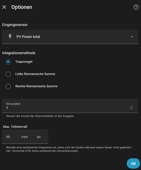

Integral & Utillity sensor resetting while reboot
Need Help Sensors resets after reboot:
This is an integral sensor why does it reset?
Thias Problem occure since 2026.3.
This is the configuration:
state of PV Power total:
    states('sensor.solarpv1_power_consumption')|float(0),
    states('sensor.solarpv4_power_consumption')|float(0),
    states('sensor.solarpv5_energy_power')|float(0),
    states('sensor.og_balkon_pv_power')|float(0),
    states('sensor.dg_balkon_pv_power')|float(0),
    states('sensor.fg2410ak3l_202_ac_meter_watts_phase_a')|float(0),
    states('sensor.fg2410ak3l_202_ac_meter_watts_phase_b')|float(0),
    states('sensor.fg2410ak3l_202_ac_meter_watts_phase_c')|float(0),
    states('sensor.fronius_meter_1_power_a')|float(0),
    states('sensor.fronius_meter_1_power_b')|float(0),
    states('sensor.fronius_meter_1_power_c')|float(0),
    states('sensor.power_photovoltaics_fronius_power_flow_0_http_fg2410ak3l_fritz_box')|float(0)
  | select('gt', 0)
  | sum
  | round(0)
an this the availibility:
  has_value('sensor.solarpv1_power_consumption') and
  has_value('sensor.solarpv4_power_consumption') and
  has_value('sensor.solarpv5_energy_power') and
  has_value('sensor.og_balkon_pv_power') and
  has_value('sensor.dg_balkon_pv_power') and
  has_value('sensor.fg2410ak3l_202_ac_meter_watts_phase_a') and
  has_value('sensor.fg2410ak3l_202_ac_meter_watts_phase_b') and
  has_value('sensor.fg2410ak3l_202_ac_meter_watts_phase_c') and
  has_value('sensor.fronius_meter_1_power_a') and
  has_value('sensor.fronius_meter_1_power_b') and
  has_value('sensor.fronius_meter_1_power_c') and
  has_value('sensor.power_photovoltaics_fronius_power_flow_0_http_fg2410ak3l_fritz_box')
the reset happens before the entry sensor has no value
