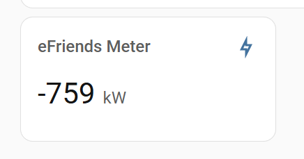

Hi, i tinkered a bit and finally got a result in my HA :wink:
put this in your configuration.yaml and you should get a “efriends_pv_meter” sensor.
rest:
  - resource: http://<your Cube IP>/v3/MeterDataAPI/getCurrentValue?format=xml
    method: GET
    scan_interval: 5
    headers:
      apiKey: "<Your API Key from the App>"
      content-type: "application/xml;charset=UTF-8"
    sensor:
      - name: "eFriends PV Meter"
        device_class: energy
        value_template: "{{ value_json['energyData']['energyBalance']}}"
this refreshes every 5 seconds on your main screen, you can change that by editing “scan_interval” up or down.
i might tinker a bit more since i want to color it red or green depending on the value shown.
Edit: Also don’t forget to restart HA after pasting this into the config file, otherwise you wont have the sensor available :wink:
Greetings from Vienna, Andreas
