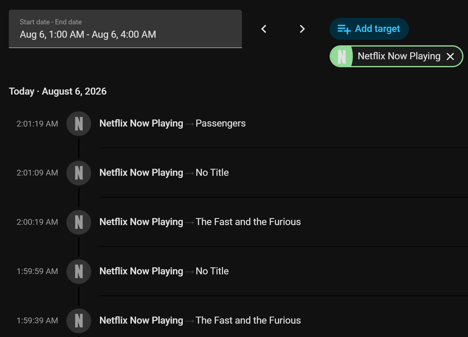

What device are you streaming from? I went a different route by using Android Debug Bridge. I was able to simplify the Playing sensor by having it update based on the media player’s action with Netflix vs a time interval.
Today ¡ August 6, 2026
2:01:19 AM Netflix Now Playing->Passengers
2:01:09 AM Netflix Now Playing->No Title
2:00:19 AM Netflix Now Playing->The Fast and the Furious
1:59:59 AM Netflix Now Playing->No Title
1:59:39 AM Netflix Now Playing->The Fast and the Furious

I was currently testing from a google chromecast 4k and that has issues with debug bridge (play state randomly disconnects)
The template might ineed be dropped but for me it was necessary since i would other wise lose controls (play,pause,vol, back next track etc) when using media player card and different streaming services/apps
I believe i also have some time interval and playstate triggers but still interested in your solution :wink:
I did inject small time delays to let the activity update via Netflix. I am still testinf so those may need increased.
