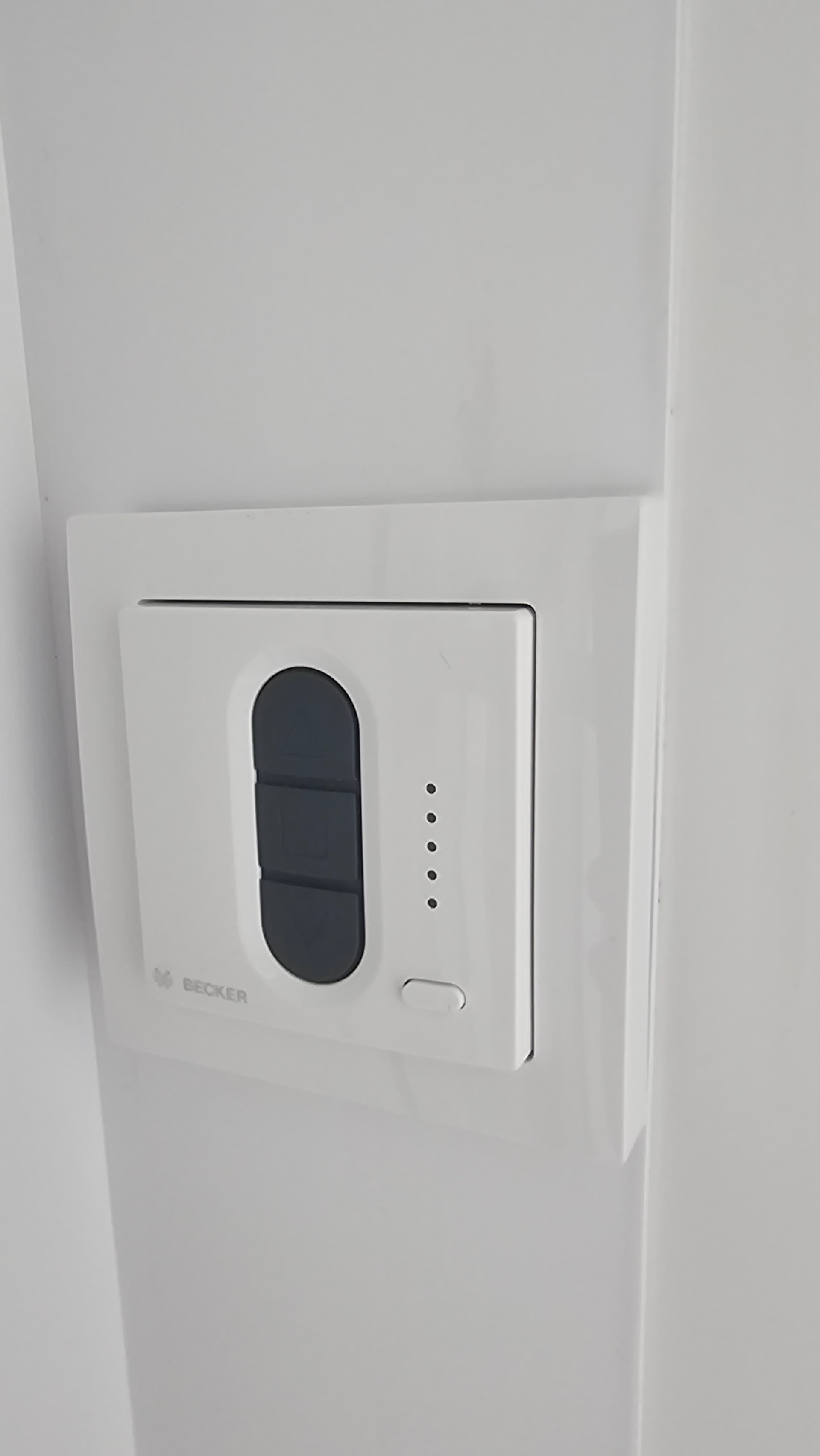

Hello RainerS,
thank you for your support!
The action is now displayed, but I still can’t manage to pair my roof window shutters with the Becker Stick.
When I set the shutters to learn mode using the Becker remote control, I hear the “click” signal - but when I then carry out the pairing action, nothing happens.
I have set the logging to debug and had actually expected to see such an output (at least the perplexity AI expects something like this - but maybe its hallucinating):
DEBUG [custom_components.becker.pybecker.becker_helper] Pairing command sent to channel 2, unit 1
But it is nowhere to be found…which smells to me like the action is simply not being executed.
I’ve restarted the Home Assistant and tried pairing again and am attaching the log file of this process, maybe there’s something helpful in there - I didn’t see anything at first glance.
The message “ [custom_components.becker.rf_device] Filename centronic-stick.db does not exist. Create a new file.” is no longer visible in the log. The file also exists in the root directory of the Home Assistant installation (“homeassistant/centronic-stick.db”).
I have now even asked Roto Support whether my roller shutters are compatible with the Becker Centronics system at all. They have assured me that they are.
Kind regards,
Marcel

What I didn’t write: After I press the learning button, my rollers go ‘klick’. I press pairing in Home Assistant after that, but nothing happens. Did someone have the same problem?
Let me look into that. Which motor are you using?
Thank you …
I bought apartment with already installed Becker rollers . And one I bought myself ,and I’m trying with that one as well

I would say that all my rollers are Becker Centronic ,because I found old bills and because they are paired with Becker EasyControl EC415-III.
I really can’t look because everything is closed and not easy to open.
Please let me know if you have any ideas or you need some information .
