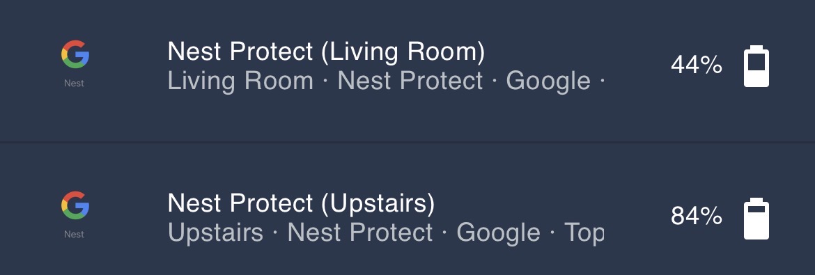

I was wondering about “Battery Level” value.
Replaced batteries yesterday but still displaying 44% and 84%
