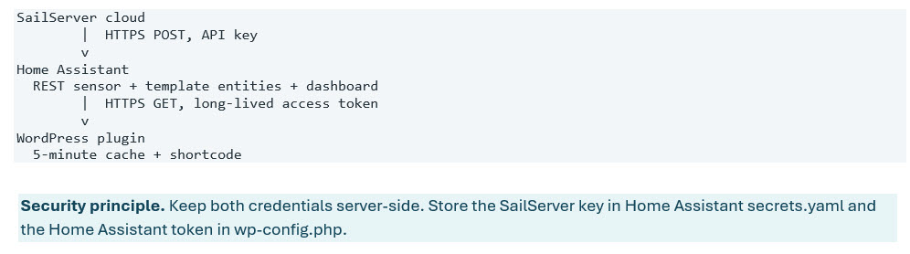

Goal and architecture
SailServer remains the telemetry source. Home Assistant polls SailServer and converts the response into sensors. A WordPress plugin reads one selected Home Assistant entity over HTTPS, caches the rendered result for five minutes, and exposes it through a shortcode.

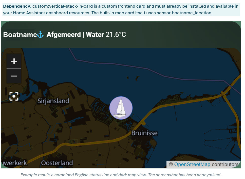

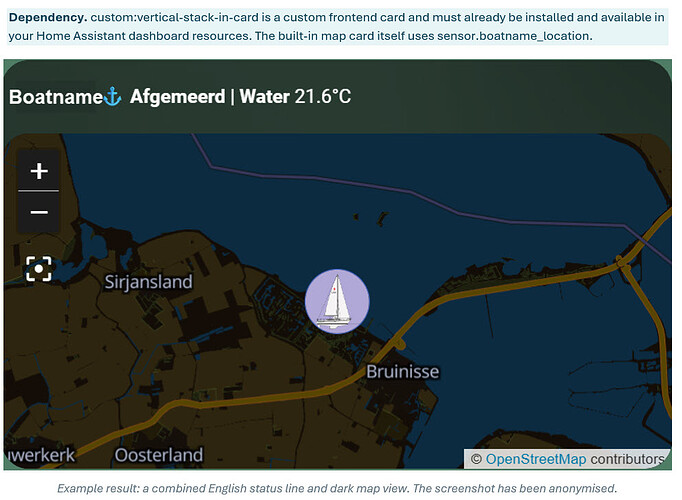

5. Add the complete dashboard card
The following example uses the custom:vertical-stack-in-card frontend component to combine the status Markdown card and a map into one visual card. Replace BoatName and boatname with your own display name and generated entity prefix.
type: custom:vertical-stack-in-card
cards:
  • type: markdown
    content: >-
    BoatName:
    {% if is_state(‘binary_sensor.boatname_underway’, ‘off’) %}
    :anchor: Moored | Water
    {{ states(‘sensor.boatname_water_temperature’) }} °C
    {% else %}
    :sailboat: {{ states(‘sensor.boatname_status’) }} kn |
    Wind {{ states(‘sensor.boatname_wind_speed’) }} kn
    {% endif %}
  • type: map
    entities:
    • entity: sensor.boatname_location
      aspect_ratio: ‘2’
      default_zoom: 12
      theme_mode: dark

  1. Create a long-lived Home Assistant access token
Open your Home Assistant user profile, create a Long-Lived Access Token, copy it once, and store it securely. WordPress sends it in the Authorization: Bearer header.
Official reference: Home Assistant REST API documentation
