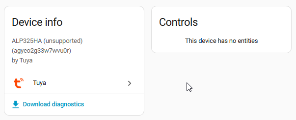

Is there an easy way to integrate Tuya (Osram) lights into Home Assistant. It would be sufficient to have the option to turn them on/off.
Both devices show up in HA in the Tuya integration, but have the status ‘unspported’.
All guides to get them working did not help.
Therefore: is there a easy way of integrating?

When you say “Tuya Integration” which one would you be referring to just the bog standard cloud integration?

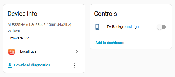

Have you had a look at LocalTuya - I have had success with getting lights and other stuff to work which didn’t via the cloud integration - I also just needed On/Off
With normal / Cloud Integration
With LocalTuya
Yes I tried via Tuya the Development Platform. But Tuya doesn’t automatically find the lights and the manual adding also didn’t work…
