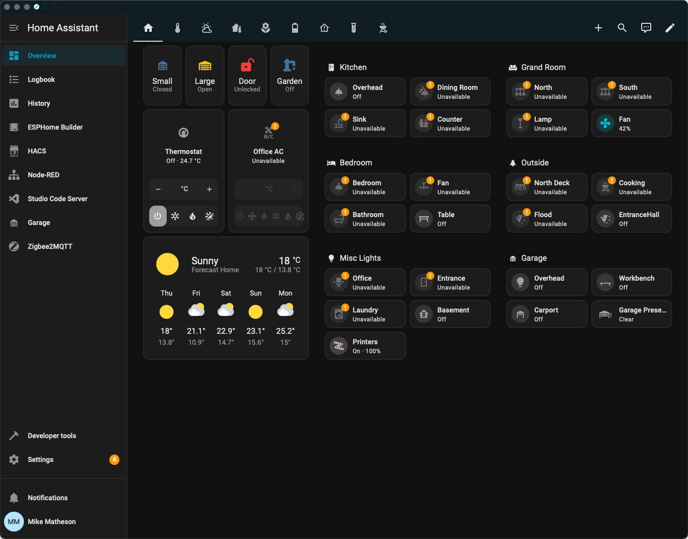

For the past couple of days, then I come home a number of my entities are unavailable. This includes Leviton switches and an AC unit … all web based integration. Rebooting home assistant fixes the issue, but I don’t want to be doing it a couple times a day.

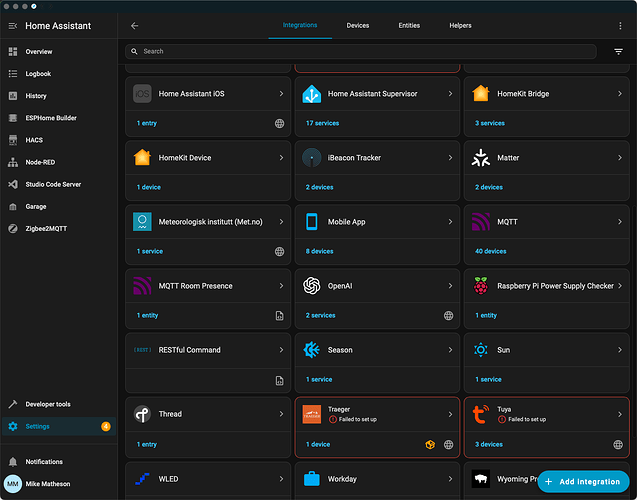

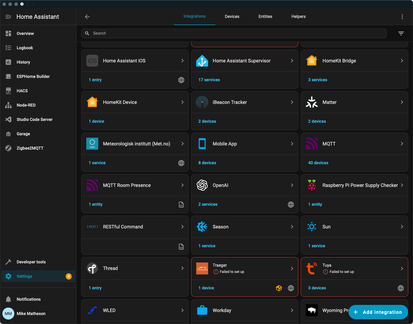

After investigating, the integrations don’t show in integration list, but after rebooting they’re all back again.
Before reboot : Leviton Missing

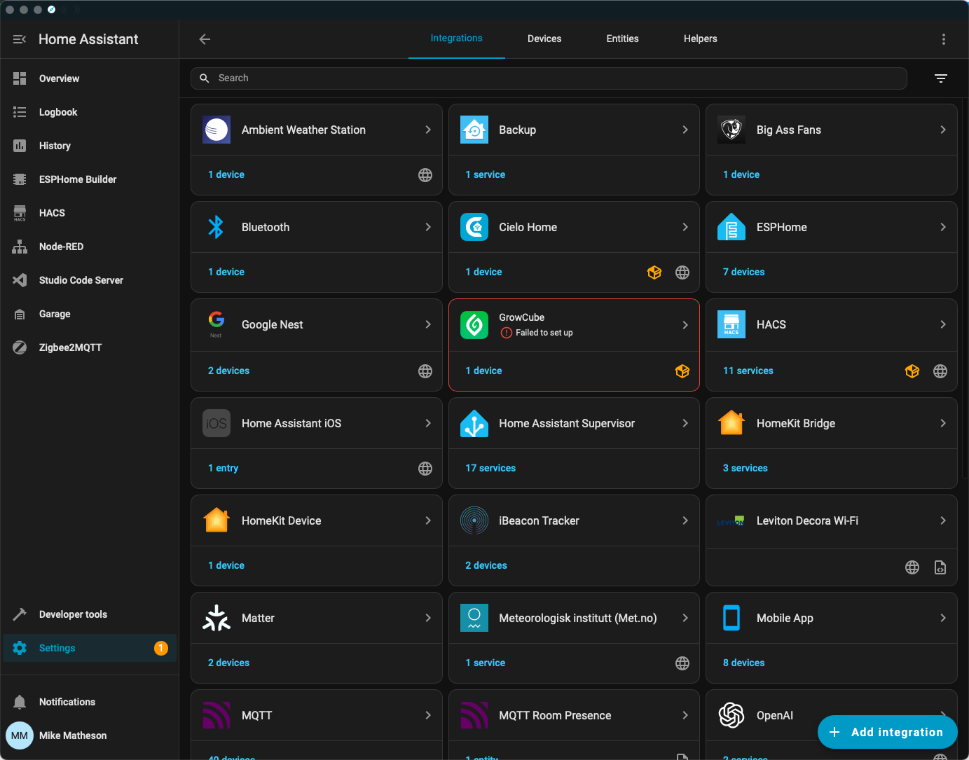

After reboot : Leviton back

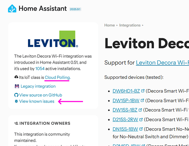

As this is a cloud integration it could be network related.
There are currently no open issues.
https://www.home-assistant.io/integrations/decora_wifi/
