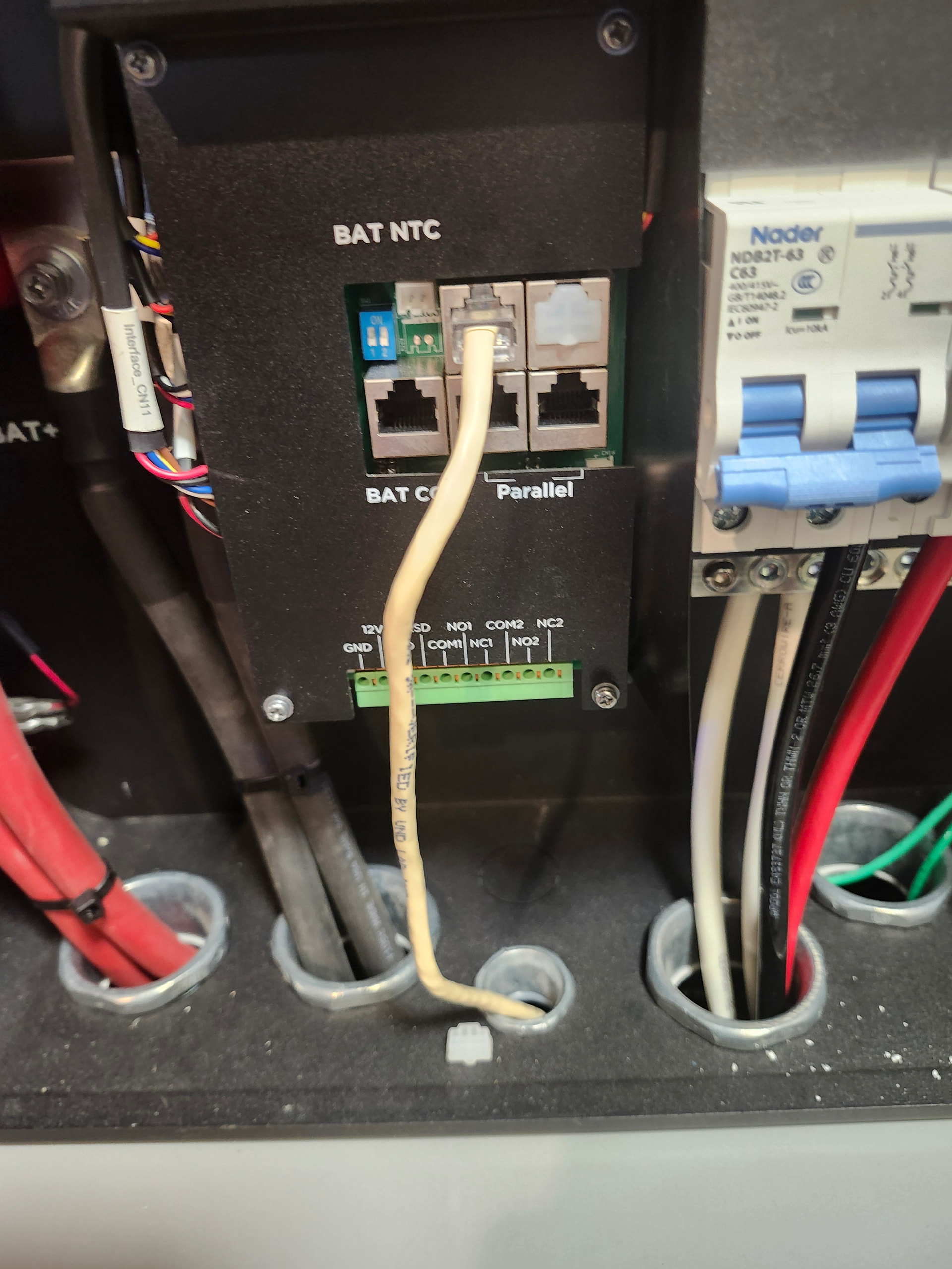

So i did finally get Solar Assistant connected directly to my eg4 12000xp. From that i can pull data into home assistant.
I had to modify the rs485 to usb cable that came with my chargeverter to use pins 7 and 8 on the rj45 instead of 1 and 2. (Try wires 1 way if they dont work, then flip 7 and 8) Plugged into ct1, which is the top middle port. I have this connected to solar assistant, set to Luxpower for the inverter.
