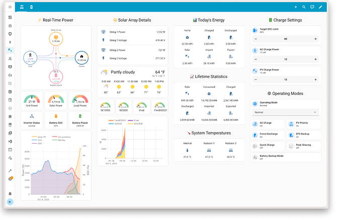

I copied the dashboard yaml into my configuration file, but my dashboard is just a bunch a tables, not nice looking graphs and charts. What do I need to do so that my dashboard looks like the sample dashboard from Git Hub?
Is it possible to expose for both set and get:
Stop AC Charge SOC(%)
On-Grid Cut-Off SOC(%)
I would like to add automation in HA to control those depending on solar forecast for the next day
You’ll need to create your own dashboard. There’s an example in the github repository.

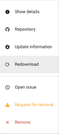

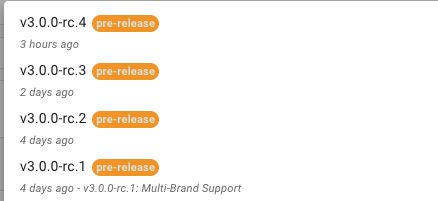

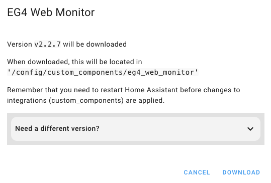

Go to the EG4 Web Monitor integration in HACS.
Click on Redownload:
Select Need a different version?
Select v3.0.0-rc.4
Please report any issues in github! Thanks!

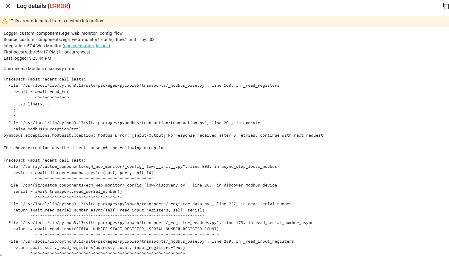

hi there, just trying to get this integration running and I get a an error “Config flow could not be loaded: 500 Internal Server Error Server got itself in trouble” during the “add integration” step.
any ideas?

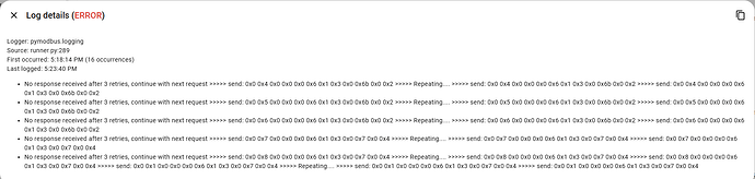

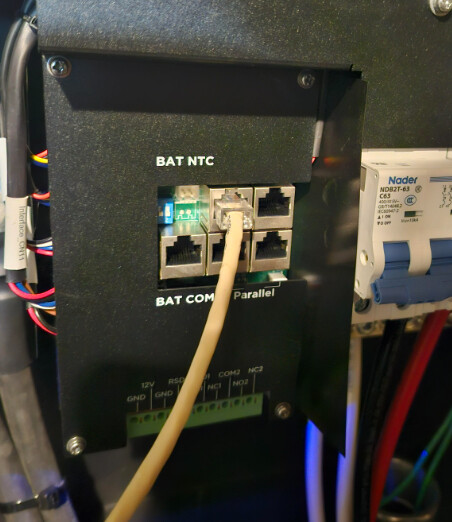

I have an EG4 12000 xp, firmware ceaa-0507 and want to connect via a Waveshare Modbus to TCP.
I have an ethernet cable with pin 1 and 2 connected to A and B
I do get a solid blue light on the converter
I have it plugged into the port shown in image.

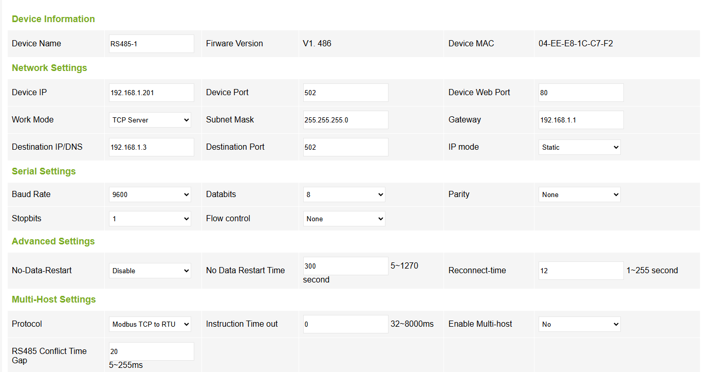

Are these settings for the Modbus to TCP device correct?
I am not sure if Device Port AND Destination Port get set to 502??
The instructions say baud 19200, but i think the 12000xp is 9600?? I have tried both…
When i try to connect it seems to just spin and then error.
If i try to auto scan the network, it does find the modbus to tcp device, but then i hit submit and it just spins and errors…
Any Help Appreciated!!

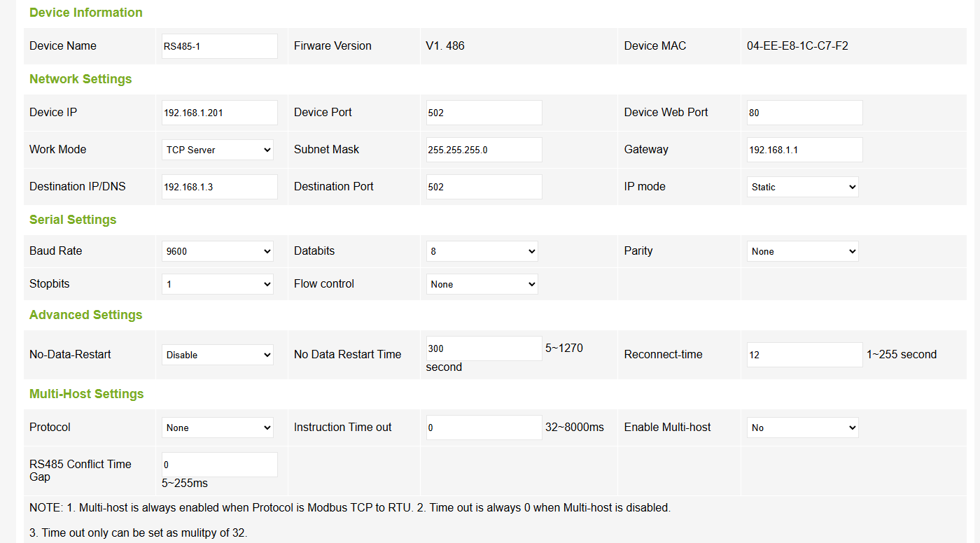

You need to set multihost settings to Modbus to RTU on your waveshare configuration
Thanks, I did try that with both 9600 and 19200 baud. but no dice…

At first i didn’t have Ground hooked to the P/E terminal.
I just repeated all the tests with the green ground terminal on the EG4 12000 XP connected to the P/E terminal on the adapter… No dice…
Also tried connecting PE Terminal on the EG4 to the adapter PE terminal…
Also FYI, My home assistant is running on a Virtual Server on a NAS… Wouldn’t think that would matter.
Only thing i haven’t tried is channel 2 on the adapter…
