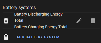

This is my setup for the Energy-tab:

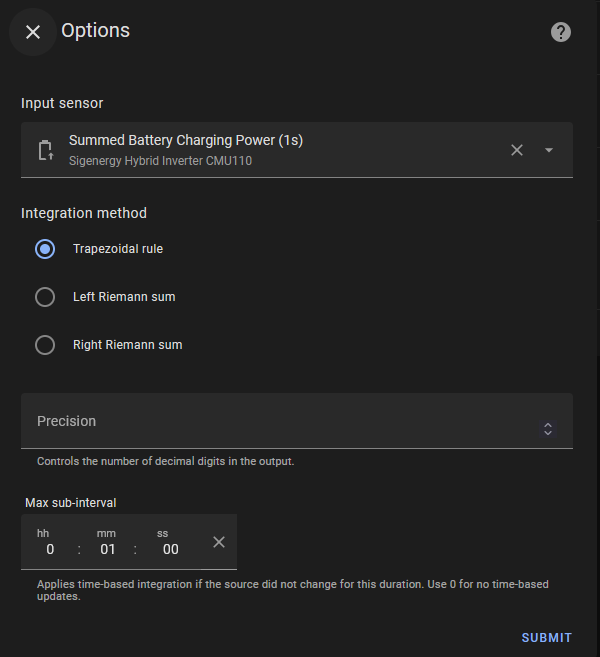

Where those 2 values are integral sensors set up like this:
After creating those 2 integrals I am just able to select them in the energy tab
Omg, so simple. I was using left rieman integral…
Trapezoidal rule did the trick. Thanks!!!
