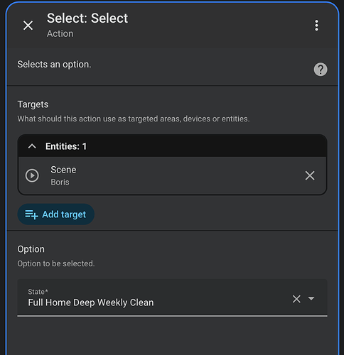

If you’d upgrade to the latest version (v1.3.2 and up) of the integration you can use the select and easily choose the scene
action: select.select_option
metadata: {}
  entity_id: select.robovac_scene
  option: Full Home Deep Weekly Clean
