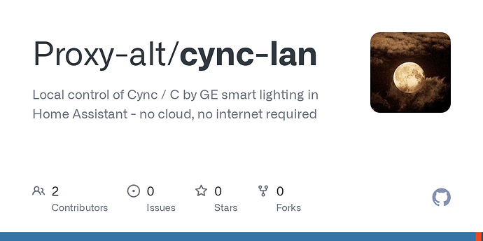

Install: HACS → custom repository. (Submitted for the HACS default list; pending review.) or use the button below:
Full setup, all the entity types, services, example automations and troubleshooting are in the integration’s own README. There’s also a Docker/MQTT add-on and a standalone protocol library in the same repo if the integration isn’t the shape you want.
Credit where it’s due: this builds directly on @baudneo’s cync-lan and the protocol work behind it.
