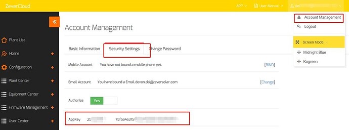

Yes, I am interested in your adjustment to process the local data of the inverter in the new Energy Dashboard of HA. But I also have a working account of Zevercloud with an api, appkey and appssecret. I requested this via email to Zevercloud and within 24 hours they activated it in my existing account. This also works. I tested this by creating an account at PVOutput. Here you can set up an automatic upload by choosing Zevercloud. Three fields must then be filled in, api, appkey and appsecret.
