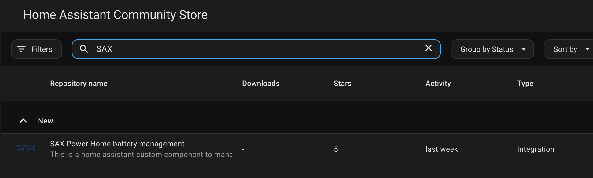

The Add-on is now available in the HACS store! much easier to install:

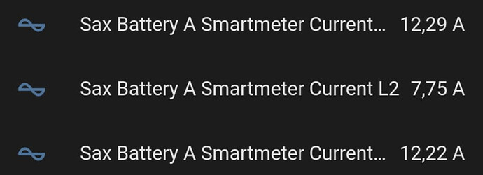

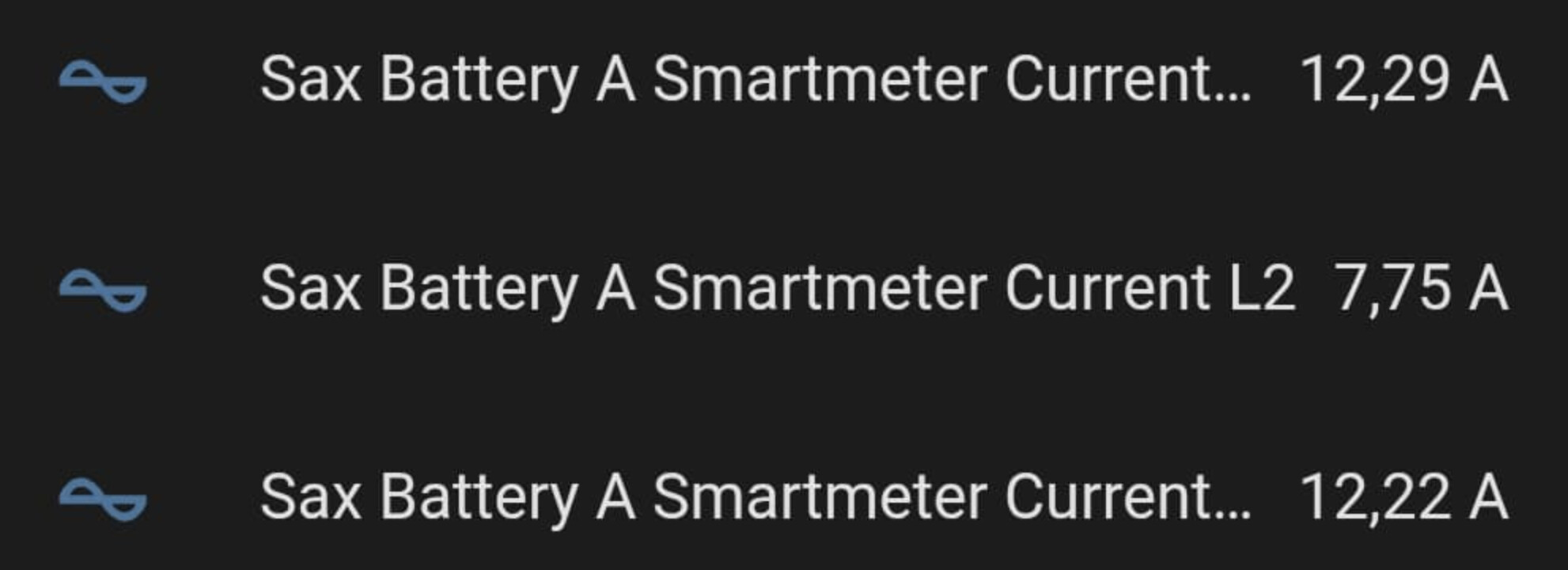

interesting!
My guess is this is your grid values, so you are right now injecting current with this Amperes on each phases. If it would be negative, you would be consuming that. Again, it’s just an educated guess.
Now from what I read in your screenshot, the voltage needs to be multiplied by 100 and those amperes need to be divided by 10 (in the documentation, the speak about a scaling factor, which was unclear, but starts to make sense here).
This then matches a total power injection of 766W at the time of the screenshot, can you confirm?
