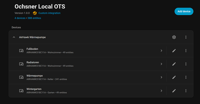

OTS-HomeAssistant - v1.0.0 Release!
It’s now a full-blown UI Integration where all you have to do is add the Repo to HACS, and then add the Ochsner Integration, enter your user and pw once, then enter your heat pump IP, and it automatically imports all readable values and even auto-translates them to readable names! No more manually searching for values with the python script!
It even groups all the values all by heating circuit when adding them.

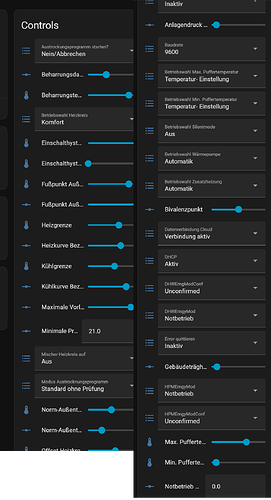

I’d recommend going through and disabling any entities you don’t need / want to control once, to reduce the polling load, and so that your HA entities are less cluttered.

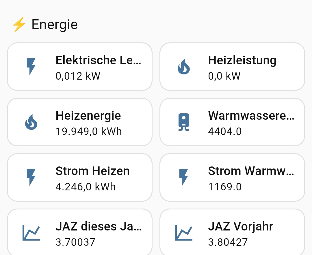

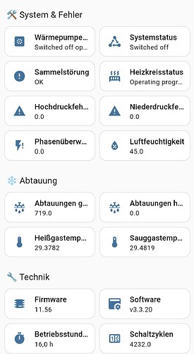

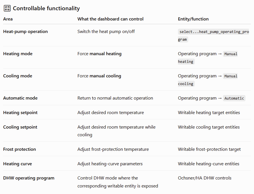

Since I have a lot of cards, badges, some automations based on the modbus interface for now I am just trying to understand how the entities interact in order to provide similar functionality like the app. With the help of chatgpt I have created a dashboard somehow similar to the app. In particular it allows to control:

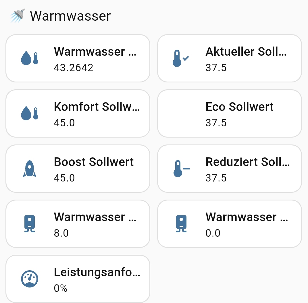

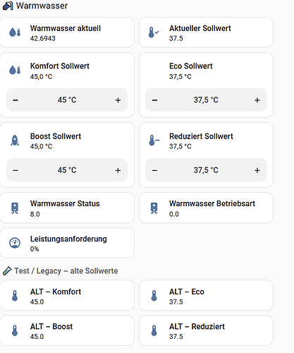

However, I didn’t manage to control the setpoints for Hot water (DHW) for eco, comfort and boost like available in the app.They are just sensors which can be monitored.
sensor.airhawk208c11a_192_168_0_3_target_value_for_comfort
sensor.airhawk208c11a_192_168_0_3_target_value_for_eco
sensor.airhawk208c11a_192_168_0_3_target_value_for_boost
sensor.airhawk208c11a_192_168_0_3_target_value_for_reduced

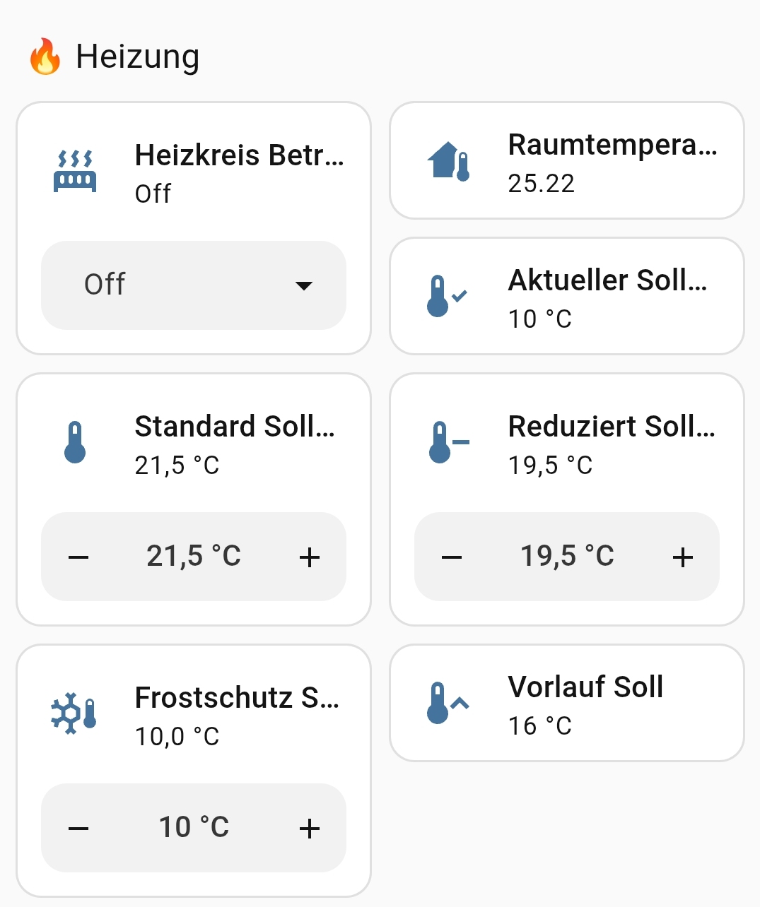

Any ideas on how to control these values are highly welcome. To me it would sound logic if those values would be numbers like:
number.fussbodenheizung_target_room_temperature_reduced_cooling
number.fussbodenheizung_target_room_temperature_standard_cooling
number.fussbodenheizung_target_room_temperature_reduced_heating
number.fussbodenheizung_target_room_temperature_standard_heating

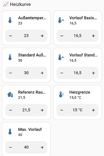

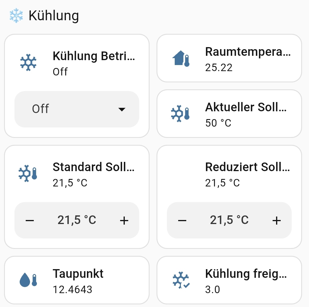

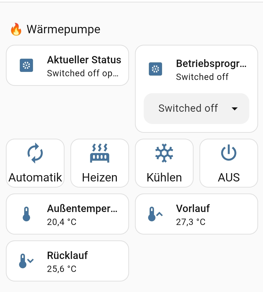

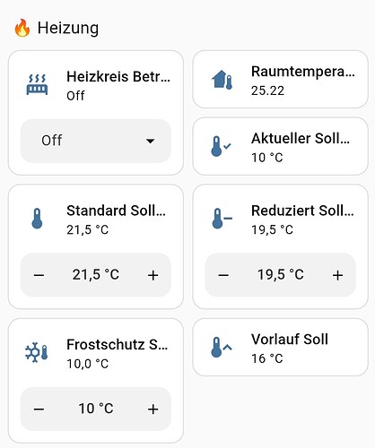

For completeness I add the cards currently in the test dashboard for app-like functionality.
so luckily I just finished my autonomos AI sandbox vm setup so all this took was copy pasting the link to your post into GPT Astra, and 5 min later we have a possible fix:

Thanks for the so quick. However I could not manage to correclty install the feature-variant with the fix.
The entities have been defined as intended:
  - entity: number.airhawk208c11a_192_168_0_3_target_value_for_comfort
  - entity: number.airhawk208c11a_192_168_0_3_target_value_for_eco
  - entity: number.airhawk208c11a_192_168_0_3_target_value_for_reduced
  - entity: number.airhawk208c11a_192_168_0_3_target_value_for_boost
However, the integration reports
Thus all entities of the integration are unavailable.
I was fiddling around, but could not find the cause of the problem so far.

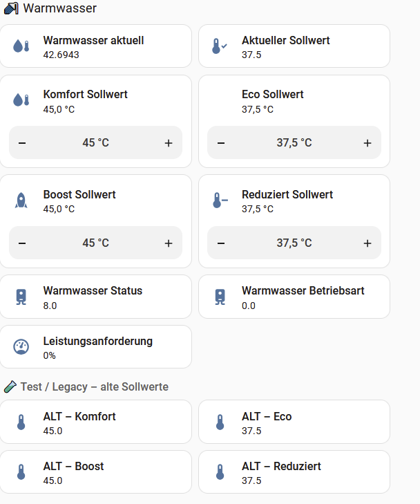

After reinstalling v2.0.0 and restarting several times the integration was loaded and the numbers were still present and had values which could be changed. Thus it works absolutely fine besides the temporary failure problem.
Thanks again a lot! Here ist the updated Warmwasser section - for now I kept the old sensors as well, they immediatly take on the value of the corresponding numbr when changed
