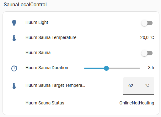

Hey there, i did some more work on the reverse engineering and prepared a HA App that is running the fake server.
  1. install app from GitHub - weidi/ha-addons · GitHub
  2. point api.huum.eu via DNS rewrite to your local HA IP (where the app is running), i use adguard but you can use anything like pihole or your internet router (if it has the feature)
  3. start / restart sauna so it picks up the new ip as target
  4. Use this package config
Summary
huum_control_huum_sauna:
  rest_command:
    huum_sauna_start:

  input_number:
    huum_sauna_target_temperature:
      name: Huum Sauna Target Temperature
      icon: mdi:thermometer

Enjoy local control!
What is missing is the steamer feature as i dont have any.
