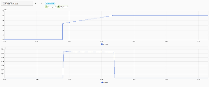

Integration sensor steps
Hi, I noticed weird behavior of integration sensor, it steps up each time the load is switched on and the total consumption is much higher.
sensor:
 - platform: integration
   source: sensor.v1_prikon
   unit_prefix: k
   round: 1
Use method: left to prevent this.
