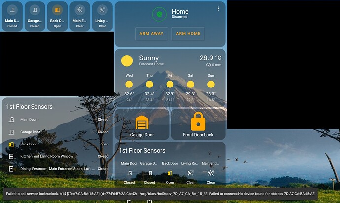

I have a level bolt smart lock integrated into the HA through the HomeKit, and for some reason, the HA is losing connection with an instance after like 30 minutes of being idle. I have to use level's native app to initiate a connection to the lock, after which the connection between the lock and HA is restored.

[139725305258976] A14 [7D:A7:CA:BA:15:AE] (id=77:F6:B7:2A:CA:42) - /org/bluez/hci0/dev_7D_A7_CA_BA_15_AE: Failed to connect: No device found for address 7D:A7:CA:BA:15:AE

Ended up replacing the Bluetooth adapter. So far works without any issues.
