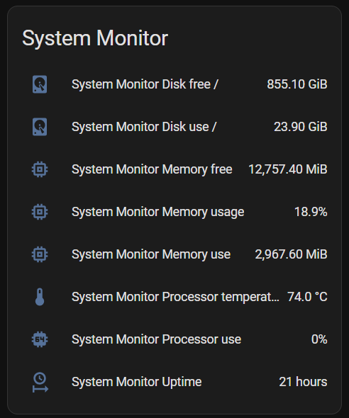

I know the System Monitor showing 74° C is like 20+ degrees too high. I’m not sure exactly what it measures; it’s the standard measurement that the integration provides. I have another HA host machine that is at a constant 20% CPU utilization and it’s only 56° C.

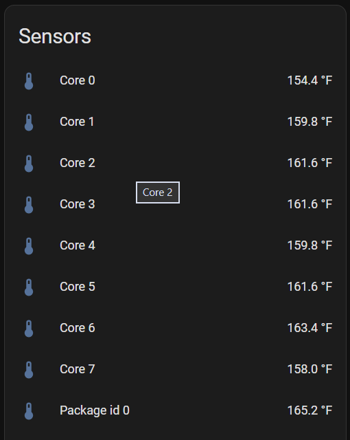

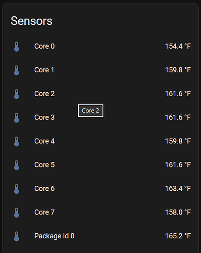

Here is what my HWMON is showing in the 74° C machine:
