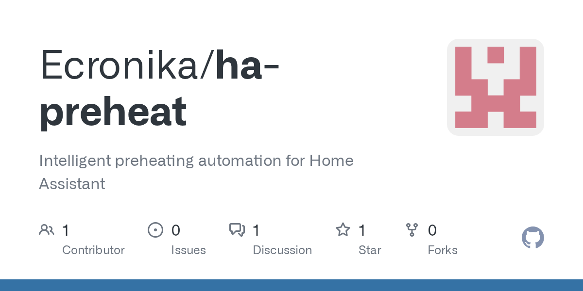

:package: Installation
It is not yet in the default HACS list.
  1. Open HACSIntegrations.
  2. Top right menu → Custom Repositories.
  3. URL: https://github.com/Ecronika/ha-preheat
  4. Category: Integration.
